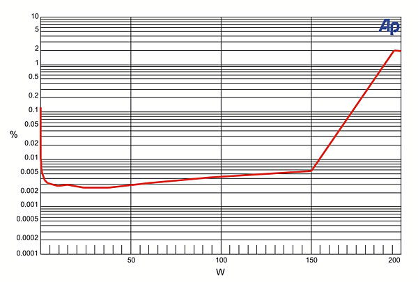

Reality check:
1. Double the power output only means 3 dB more sound pressure level (spl). Rule of thumb is, you need 10 dB more sound pressure level to give the sensation of the "twice as loud".
2. From 150 W to 120 W, there would make a difference in spl of only 0.97 dB, that's just one click on the volume dial!!
3. So in fact, relative to the quite powerful AVR-4520, the Monolith 7 or Outlaw 7220 will therefore not be "overkill". Going from 150 W to 200 W means you gain 1.24 dB, less than 2 clicks on the volume dial.
4. Hearsay will have you believe that even at very low level (fractional watts to a few watts),a more powerful amp will sound better, fuller etc., that's totally illogical, just think about it.
If you compare the measurements of the 4520 and Monolith 200X7, with two channels driven, into 8 and 4 ohms, the difference translated to spl is only between 1-1.5 dB. You will get more gain in the 5, 7 channel driven situations, 1.8-2.2 dB, significant to potentially make a difference if you listen to 7 Ch Stereo at or near reference level sitting far enough away, say > 11 to 12 feet.
So you can see that if you want the additional amp to make a real gain in power for you speakers, you really have to start with the Monolith 200X7, and up from there, not down.
Power output comparison:
AVR-4520CI
https://www.soundandvision.com/content/denon-avr-4520ci-av-receiver-test-bench
Two channel driven:
Into 4 ohms, the amplifier reaches 0.1% distortion at 237.5 watts and 1% distortion at 287.1 watts.
5 channel driven:
Into 8 ohms, 121.8 W
Monolith 200X7
https://forums.audioholics.com/forums/threads/i’d-like-to-add-an-amp-but-don’t-know-if-i-really-need-one.112629/
Two channel driven:
Into 4 ohms, the amplifier reaches 0.1% distortion at 345.6 watts and 1% distortion at 400.6 watts.
5 Channel driven:
Into 8 ohms, 185.8 W.
