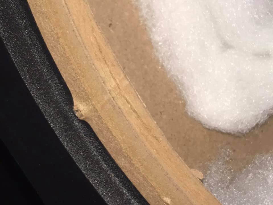

I just got this bad boy brand new from HSU and installed it in the corner. One port open, eq set to "1". Gain is set at 12 oclock, internal crossover disabled, crossover in the Denon amp at 80Hz.
Getting a strange rattle from the subwoofer cone on certain very low passages where the bass is a longer extended note.
It is not from the enclosure or the surrounding wall/baseboards etc.
Noticed this on very deep musical bass heavy tracks like Impend from Halo 2:
And also Heretic, Hero from the same soundtrack.
Everything appears to be in order on the sub, all the face mounted screws are tight.
Suggestions?

Can you run a sweep to see what frequencies it is prevalent at? Use a tone generator like this. Slowly slide the frequency from 16 Hz to 100 Hz to see if it is occurring at a specific frequency. Can you describe the offending noise more specifically? Is like like a sharp tapping noise or a softer fluttering noise?

Definitely a sharp tapping noise rather than 'chuffing'. I thought it was the enclosure rattling or maybe some baseboard trim. But once I got my ear right up against it, it definitely sounds like the woofer cone itself. Happens with or without the grille on too.

Yep, happens distinctly from 15hz all the way 55hz with a test tone generator :(

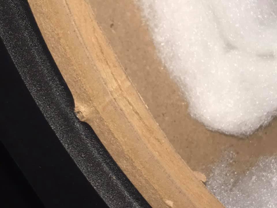

I'm pretty sure I found the issue:

And also here at this mounting point (it's a little harder to see here, but there is a large stress fracture from the screw being over tightened).

It sounds like the driver has been knocked out of alignment. This can happen if the sub is subjected to a drop or impact during shipping. Contact Hsu. They will have you run some tests to be sure that is the case. If they determine that is the cause, they will send you a new driver.

And also here at this mounting point (it's a little harder to see here, but there is a large stress fracture from the screw being over tightened).View attachment 28210
Hmm, I wouldn't think that kind of damage would cause the kind of problem that you are experiencing. None the less, I think that entire unit should be replaced. I am sure that Hsu will take care of you.

They are sending out a new sub tomorrow morning first thing.
Excellent customer service and follow up.

Could very well be that it was damaged during shipping. Still, that first pic of the split mounting point looks even worse in person.
All in all they are taking care of it so I am happy as a clam. Will report back when I get the replacement unit.
