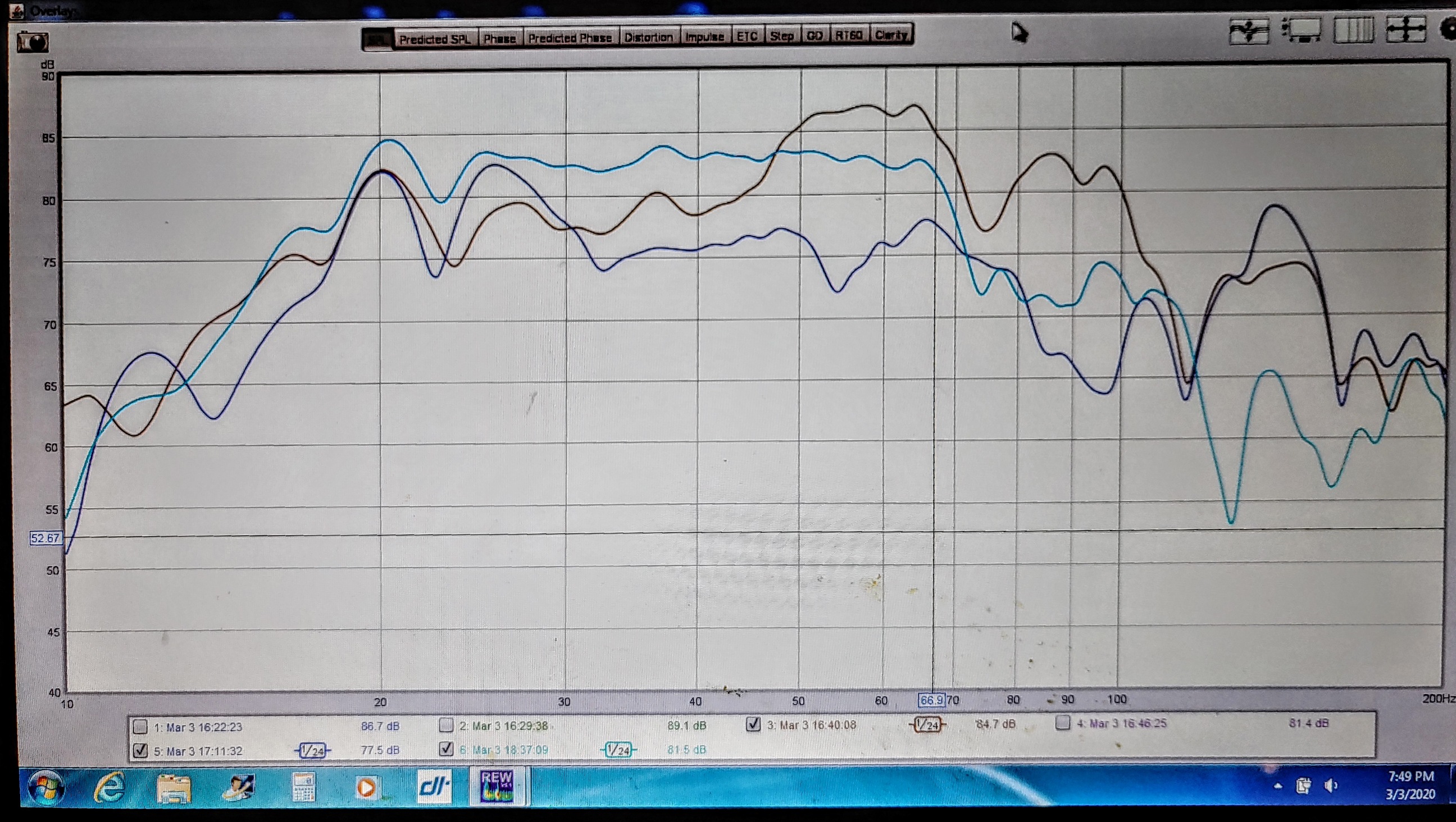

Ok so first of let me say these are some fantastic subs. Needless to say everything ive read about them was pretty spot on, the system is on a whole new level now. Spent half of the day taking measurements in REW and would like to share what i got so far and ask for your thoughts. The below graph is in a 40 to 90db and 10 to 200hz setting. HSU suggested using one sub in a near field location and the other in the corner so i tried that first. The brown line is before audyssey the light blue line is after i ran audyssey. The dark blue line is both subs in the front corners before audyssey. Of all the locations these 2 seemed the best. Any thoughts?

Ok so first of let me say these are some fantastic subs. Needless to say everything ive read about them was pretty spot on, the system is on a whole new level now. Spent half of the day taking measurements in REW and would like to share what i got so far and ask for your thoughts. The below graph is in a 40 to 90db and 10 to 200hz setting. HSU suggested using one sub in a near field location and the other in the corner so i tried that first. The brown line is before audyssey the light blue line is after i ran audyssey. The dark blue line is both subs in the front corners before audyssey. Of all the locations these 2 seemed the best. Any thoughts? View attachment 34406
The bright blue line is really good, at least up to 70 Hz. It's a shame that Audyssey knocks down output above that point. It is such a shame, in fact, I recommend bypassing Audyssey and manually EQing them. The real problem in the response is the bump from 50 to 70 Hz. If you could just knock that down, the rest isn't bad. However, Audyssey is flattening that out but not without tanking an important region of mid-bass.
I'm glad to see that you are verifying what Audyssey is doing with measurements instead of just assuming its making everything better; it isn't.
Audyssey does the same thing with my room too. In order to tame a huge peak it drastically reduces one band at the expense of some mid bass.
Curious, how many mic positions are you measuring with as per the graph posted?

I have a 3 person couch that graph is the middle seat i ran the seats to the left and the right to see if anything was drastically off from the main seat and it wasnt too far off it seemed

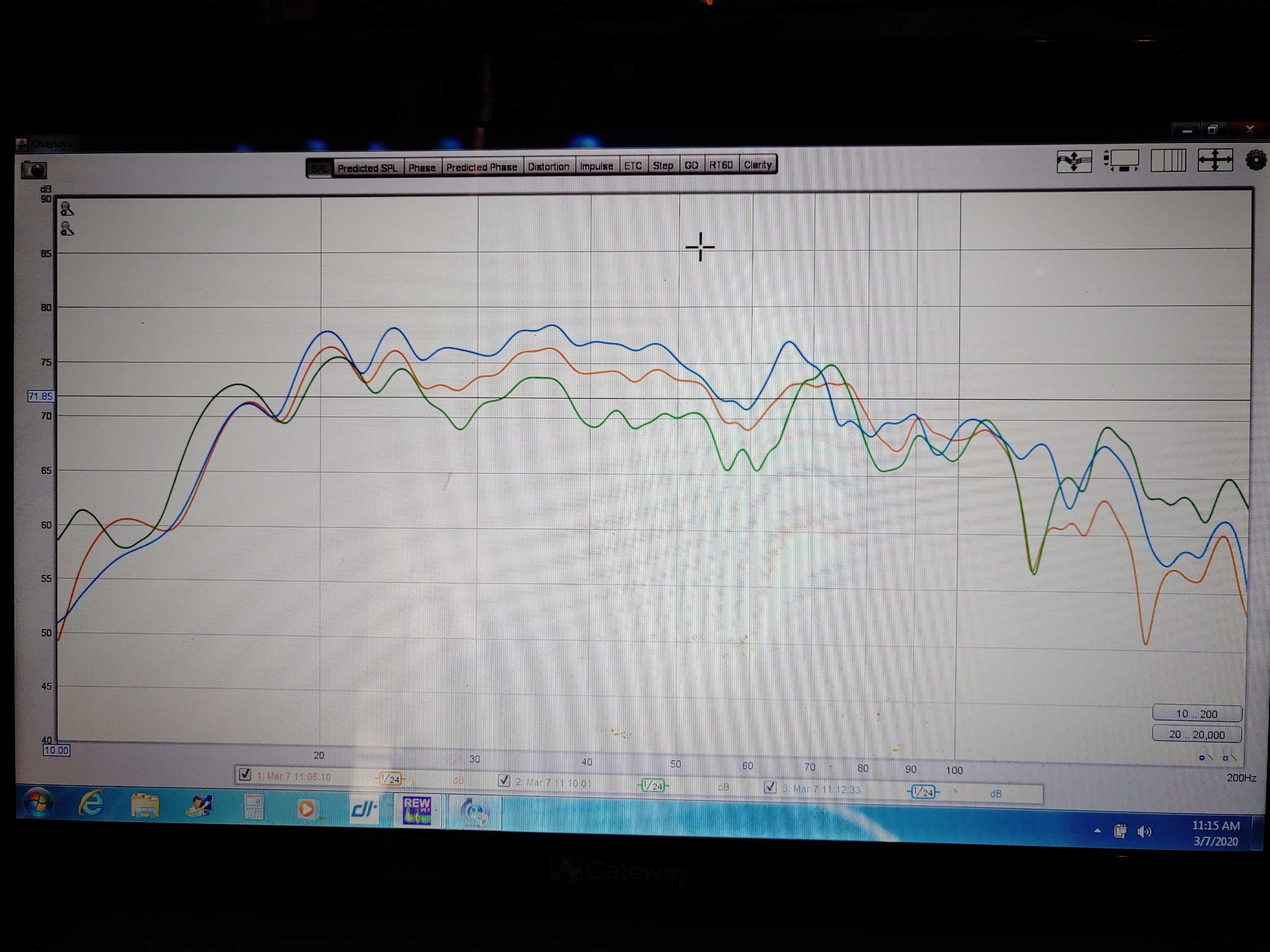

Well after alot of moving and measuring and yelling at the kids bcuz the made a noise during a measurement i think i found the best its gonna get. No audyssey, here are the 3 main listening positions the orange is the middle main seat the blue is to the left and the green is the seat on the right. Is this a decent response? After some hours playing music and movies im still damn impressed with the hsus. It was a good decision imo.

Well after alot of moving and measuring and yelling at the kids bcuz the made a noise during a measurement i think i found the best its gonna get. No audyssey, here are the 3 main listening positions the orange is the middle main seat the blue is to the left and the green is the seat on the right. Is this a decent response? After some hours playing music and movies im still damn impressed with the hsus. It was a good decision imo. View attachment 34488
If you use the camera icon you can do screen caps that are much easier to read. Just save them and upload like usual.

Wow. I audyssey? Pretty good. I would definitely run it and at least see what happens.

Yeah, blue and yellow look pretty good, and green isn't terrible. That's not bad at all.
*Edit: I have a lot of squiggles in that 60-90 hz range like you do, lol.
That isn't a bad response. There is a some room for improvement, but not a whole lot. The orange curve is the best, so the middle seat is the sweet spot. If you run Audyssey, make sure to compare the before and after. As was mentioned before, don't assume Audyssey will make improvements. Verify it.
