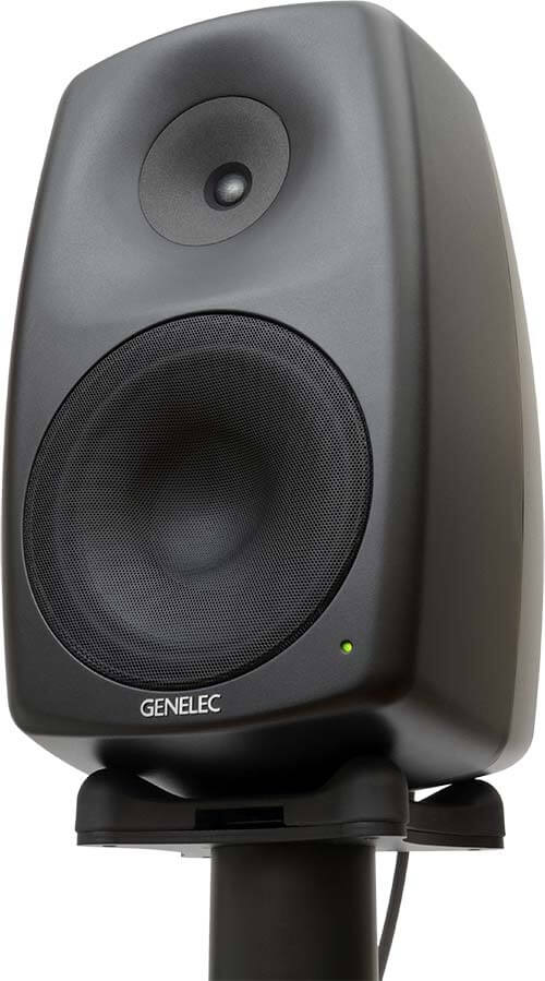

Genelec 8260A
Those speakers have a lot to recommend them. A nice smooth response.
However they tried to guild the lily and spoil the result.
These are third party measurements.
This is the curse of commercial speakers. They have to play the numbers game., in this case getting an F3 of 29 Hz in a relatively small ported box. You can see from the response, this is almost certainly and extended bass alignment, with ripple in the audible range and prolonged decay in the lower octave. This contributes to the relatively poor step response. This will be audible and be unpleasant. It would be to me anyway. The other issue, is they left a loose end.
This is an active DSP speaker and yet there is inter diver delay. With this design, this is something that could and should have been taken care of for the amount charged.
By contrast this is what mine looks like.
I just don't understand why you bring a high priced studio monitor to market and don't cross the Ts and dot the Is. This is especially true in this case, as if this had been attended to, I suspect it would be a really stellar performer.
I know the argument is that this type of error is not discernible, to which I say "bunk".
