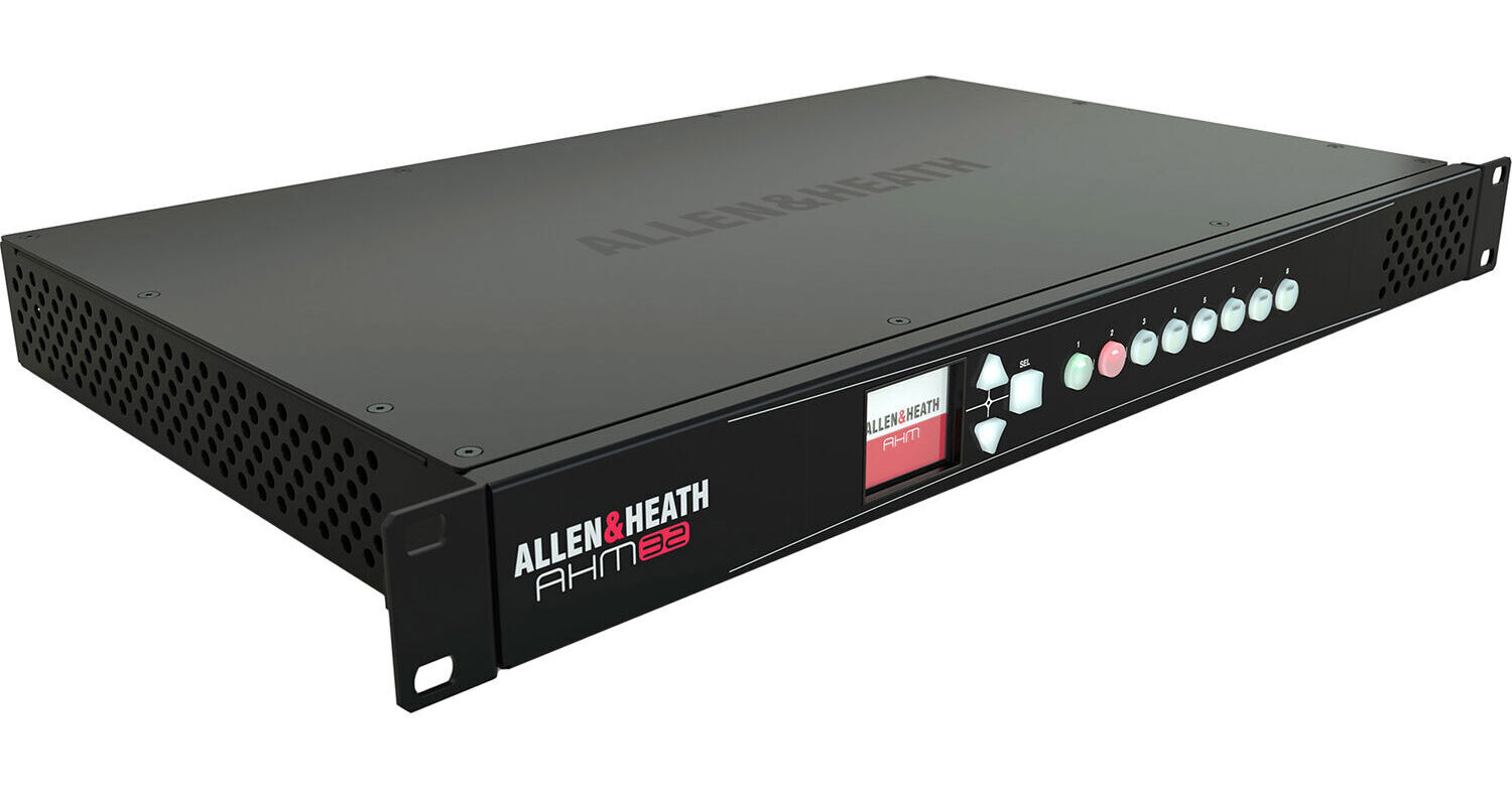

Not sure I like that its rackable lol it's why I'm asking I have no idea of its any good for what Id like to do its another noob question
Looks like it'd work, particularly on a rack but kinda pricey unless you're planning on six subs or tri-amping a pair of speakers or something down the line :)
I also like how the Mackie the inputs are xlr I can just use the outputs on the preamp and go then to the xlr on the crown but I'm okay with either one especially the less money one

Plus I'm worried that little mini dsp will just fall off I don't really have any place to set it so I like the idea of the dsp being rackable since I have that giant rack anyway
Hey I saw one I like better cheaper too
