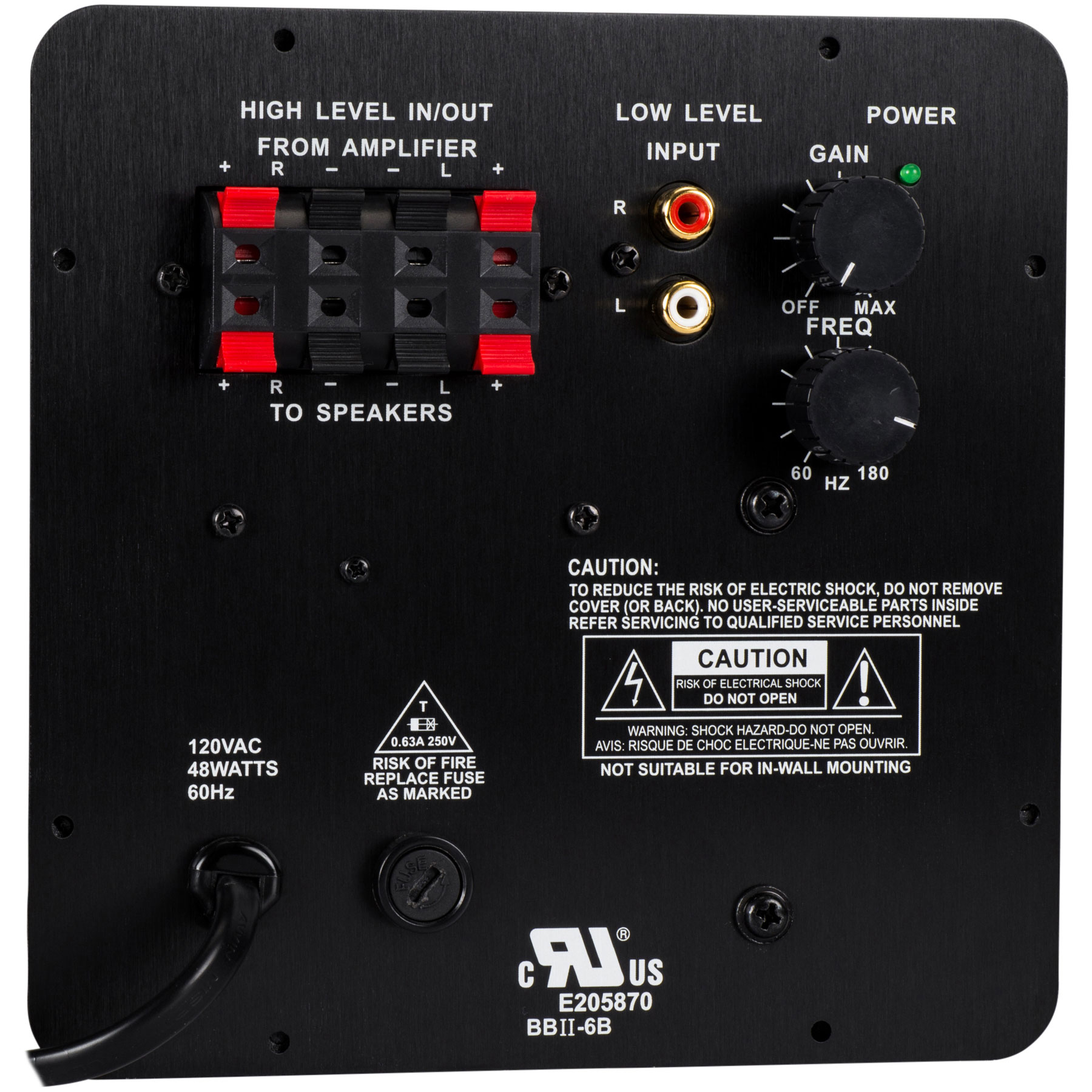

The speaker wiring would be from receiver speaker terminals to both the sub and the speakers simultaneously (the sub will take the stereo inputs and sum it to mono). Some subs have an extra set of output terminals to the speakers for some flexibility like this pic I plucked off the 'net:
My Outlaw LFM plus subwoofer has speaker level in and outs like shown above.I’m not sure if their new subwoofers offer them.
With just 4 speaker connections, can I run a split from receiver to speaker, receiver to sub?
My bad. Looks like I can go from sub to speaker.
Keep in mind these older units had more like one pair of speakers at a time in mind for the A/B speaker connections. If you run them simultaneously with two pair of speakers you have to keep total impedance load in mind (so two pair of 4 ohm speakers could be an issue). You could use the "B" terminals for the high input levels on the sub, tho (or share them with A, the high level inputs on a sub do not have the load passive speakers would).
It would be just the sub and one pair of speakers. I think with the Dayton you can go from receiver>sub>speakers. But correct me if I'm wrong. The speakers have an 8 ohm.
With a sub amp that has both in and out high level terminals you can do that, otherwise you could use wires from the B terminals just to the sub, too. Or split to speakers/sub from A alone.
