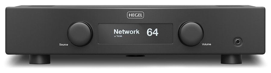

I was blown away by this stereo side by side comparison test and thought I would share. Until I tried this direct comparison, I did not realize the difference with the BMRs.
My Denon 4700 and the Hegel H90 are normally in different rooms. Until now I had not thought a direct comparison would yield much difference. In fact, I thought the 125W of the Denon might reinforced the sound. To my surprise, that was not the case....

I have been using the Hegel H90 with my BMR's for stereo in my office for the last month. The Hegel H90 is rated at 60W a channel. It's an integrated amp with a USB port along with several other inputs. The Hegel H90 shows up as a sound card on the MBP when a USB cable connects the computer to the H90.
As the Hegel H90 has a relatively low 60W rating I wondered how the 125W Denon AVR-X4700H would work as a replacement for powering the BMRs.
What did I find?
The Denon 4700 sounds like WEAK SAUCE compared to the Hegel H90. I have to turn up the Denon to 65 to get the same volume level as the Hegel H90 at a 50 volume setting. And even then the bass sounds weak and that's with Denon Dynamic EQ turned on the 4700. The H90 has no EQ settings just awesome sound and power.
The Denon sounds so weak in an A/B blind test that I guessed it was the 60W amp and the Hegel H90 was the 125W. I am blown away. I never would have guessed the difference would be this HUGE. The Hegel H90 sounds so much better than the 4700 in this stereo BMR side by side test.

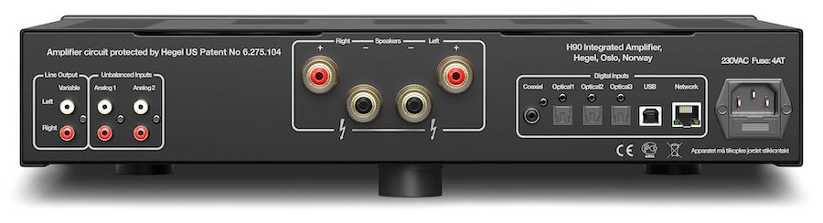

@PENG - How would you measure the Hegel H90 with REW when there is no HDMI port? What type of cable do you recommend in that situation? Can I simply use the USB cable for REW measurements?
