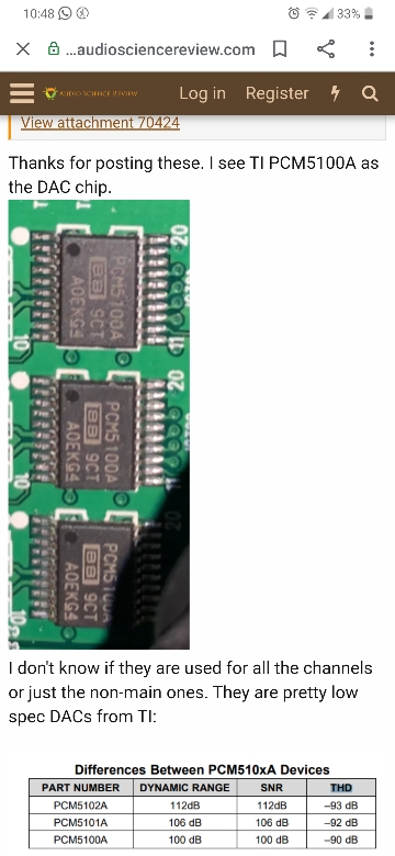

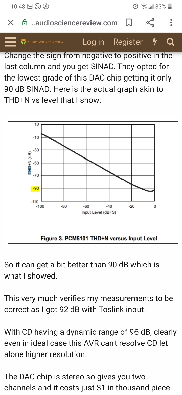

Doesn't Denon X4700H have its own DAC?
Source: "Denon AVR-X4700H 2020 AVR Review | Page 32 | Audio Science Review (ASR) Forum" https://www.audiosciencereview.com/forum/index.php?threads/denon-avr-x4700h-2020-avr-review.14188/page-32

FYI, the person who posted those had mistaken the zone2 DAC for the main. For the main zones, it is the AKM's AK4458, that has similar specs to Yamaha RX-A2080's Sabe ES9006 or 9007. There were follow posts that clarified the mistake.
Yamaha used a lower grade DAC too, but it is the PCM5101 that has 2 dB lower THD+N.
