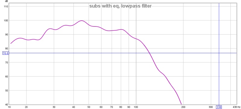

Oh, I jumped in the waters. Got my mini hooked up now with filters generated by REW, then ran Audyssey. Check it out:
I'm pretty damned happy with this result. There is no smoothing in this measurement. I'm gonna just listen and enjoy for a while now. I'll prolly go back and do some more in a week or 2. See if I can do something about that dip at around 22hz and smooth out the response above 120hz or so. There is a definite, audible improvement in my system.

This one looks pretty good. Looks like you have a nice house curve going there. A little peak at about 45hz and a saddle between 50 and 90hz.
You're getting much better extension with your deeper bass now. You have to be able to hear it too. I'm just learning here, but I'd try putting a +3db low shelf filter on there and see what it does. I'm getting a little bit deeper bass than my subs are spec'd in my room. If your subs are good to 24 hz you might be able to get it down close to 20.
Before doing that though, I'd consider moving stuff around a little and see how smooth you can get with just placement first. Do a control sweep with no eq, no Audyssey or filters at all, then see if moving things around, even a few inches either way, makes any improvements. Take another sweep after every adjustment and compare.
One big factor for me was getting my speakers a little further from the walls and moving my subs closer together. That made some improvements by itself. Then I didn't have to do as much with the mini, which made things easier for Audyssey.

Be careful, those subs simply are not designed to play low. Boosting at and below resonance of the woofer is a great way to over work the driver and produce that 'one note bass' symptom. Think car audio, BOOM BOOM. Loud? Hell yeah! Accurate? Not a chance!

Yeah, that's why I put a little disclaimer in my post, "I'm just learning here.". I don't know enough about PEQ to give rock solid advice.
I think the part of my last post to focus on would be messing with placement a little first, before adding any PEQ or Audyssey. I think that helped my case as much as adding the mini did.
