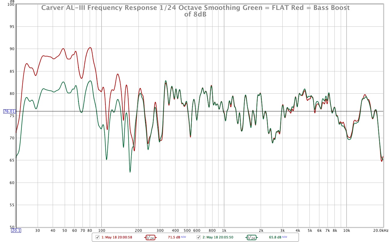

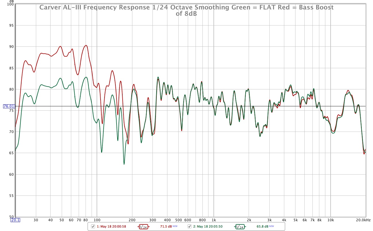

More graphs. I hope I made relevant ones. First up, Waterfall decay plots to 200Hz up to 450ms, without boost and below that with bass boost and a full bandwidth Spectrogram (bass boost one didn't look much different). I've also included a RT60 block plot. It looks like the decay range is a bit higher than recommended (300ms) at mostly 350ms, but not terrible (probably due to the active back wall; if I put up a tapestry on that wall I bet it'd improve somewhat). I don't know about that 60-70Hz bit that's longer?

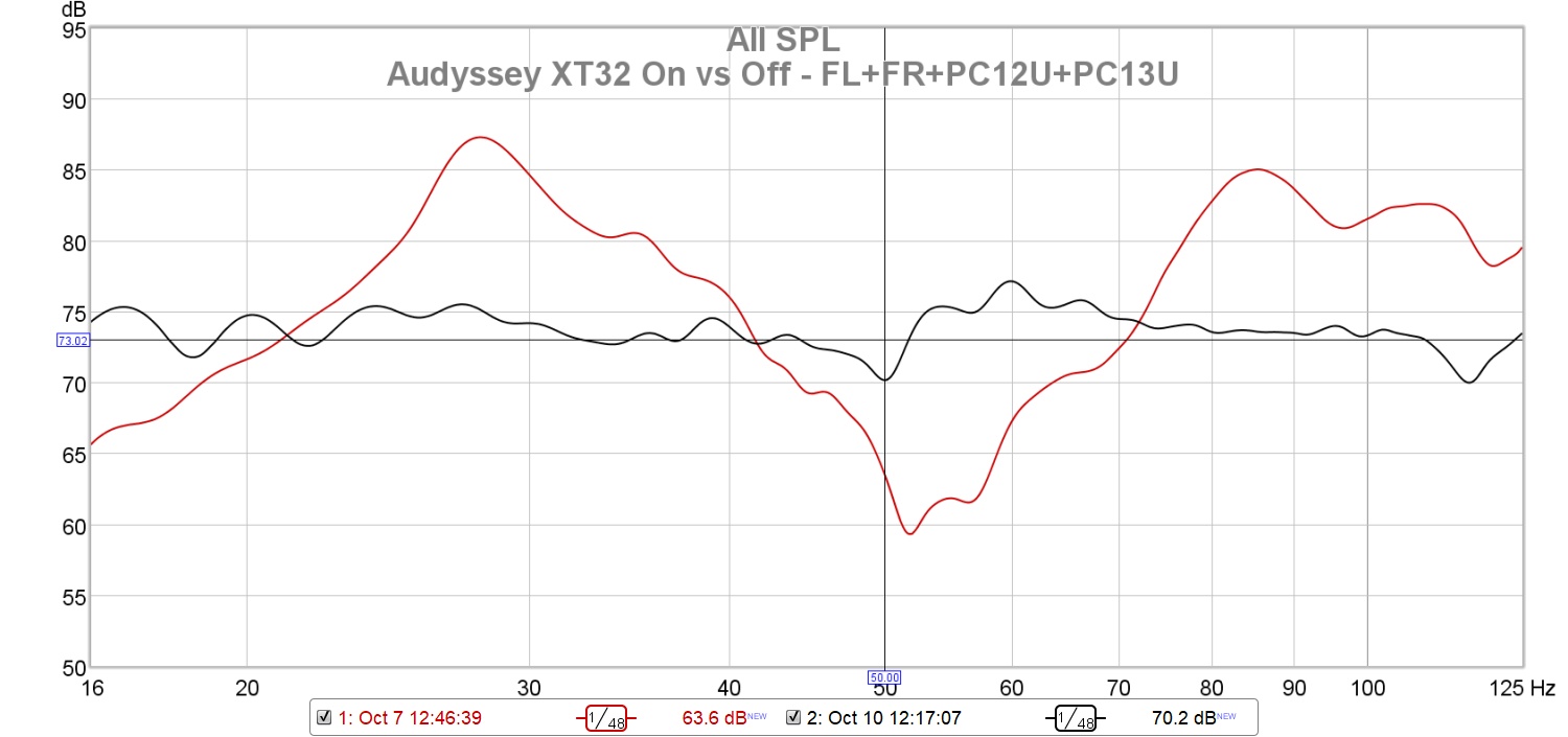

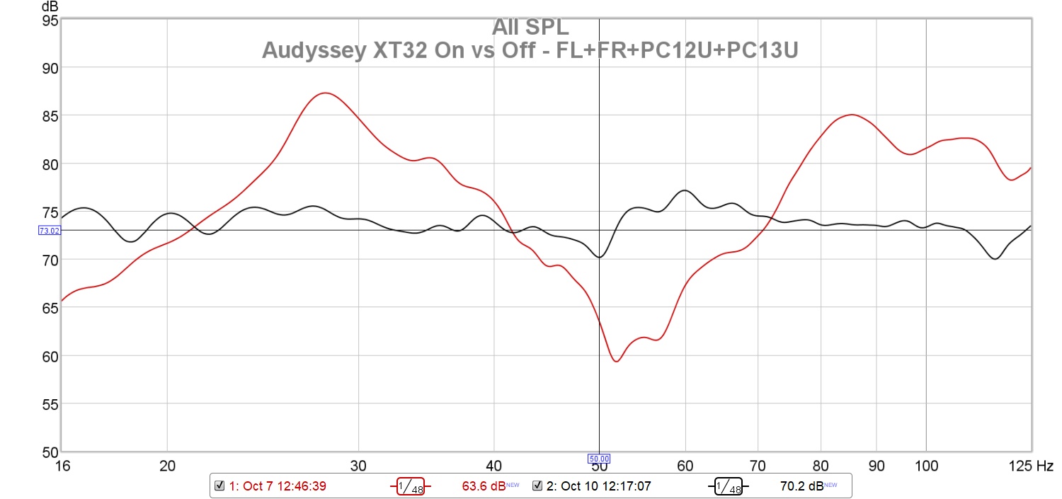

Good point, it is not a sure thing that you would hear a difference let alone a better difference. Below was what I achieved when I had the AV8801. My AVR-X4400H is doing a better job now, especially with the Editor App. You can see that in my room the FL, FR and subs did not play nice at all in the low range so surely anyone could hear a difference in my case, not just on paper.
XT32 did a pretty good job on its own, minidsp+REW did help a little but I didn't feel it's worth with the additional hook up and cables dangling, ymmv..
Not that this is a 45 dB window, and 1/48 smoothing. If I use 1/6 and 60 dB window it would look more like a straight line lol..

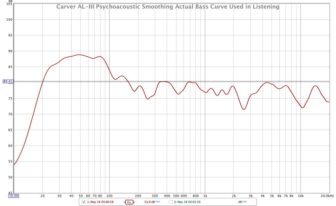

That looks pretty good, but keep in mind I don't use the 'green' graph on the Carvers above. I use the red one so that nasty green dip actually lines up well with the rest of the graph in reality (this is the Pyschoacoustic Smoothing --best guess to what the software thinks I'll actually 'hear' in the room) with just the actual used bass curve shown. Suddenly the dip at 2.7kHz and 10kHz look the worst (I wouldn't trust the 10kHz one at all as moving the mic an inch could change it entirely (and certainly turning down the top trim makes it just smoothly fall flat instead there rather than rise back up again after 10kHz) and I'm not so sure the 2.7kHz one is reliable either as it could vary within the distance to my ears even (taken in the middle). All Dirac or Audyssey would want to do is tame my bass curve when it's a nice smooth sounding descent to 'flat' at 200Hz right now.
Really, from what I've read my worst measurement is the time for the room to die down (450ms isn't desirable for a studio environment; 300ms or less is). I made my rock album in this room and while only vocals and acoustic guitar were recorded with a microphone (everything else was direct in to keep noise levels low, etc.), it sounded pretty damn good (Pink Floyd like sound quality on the album and at a tiny fraction of a studio cost even renting a commercial one would have cost). +/- 5dB is considered good for room freq. response in a studio. They want the other parameters pristine more than freq. response according to a forum I've been reading and getting some of the others in line is much harder (all room treatments, not room correction that can bring ringing down one iota, etc.)
I thought you dialed things in manually and that's very good results in the 25-90 Hz region. Above Schroeder, we both know the results are not too reliable, manual, Dirac, or whatever, probably are not reliable regardless, but one can try it, and go by ears.
