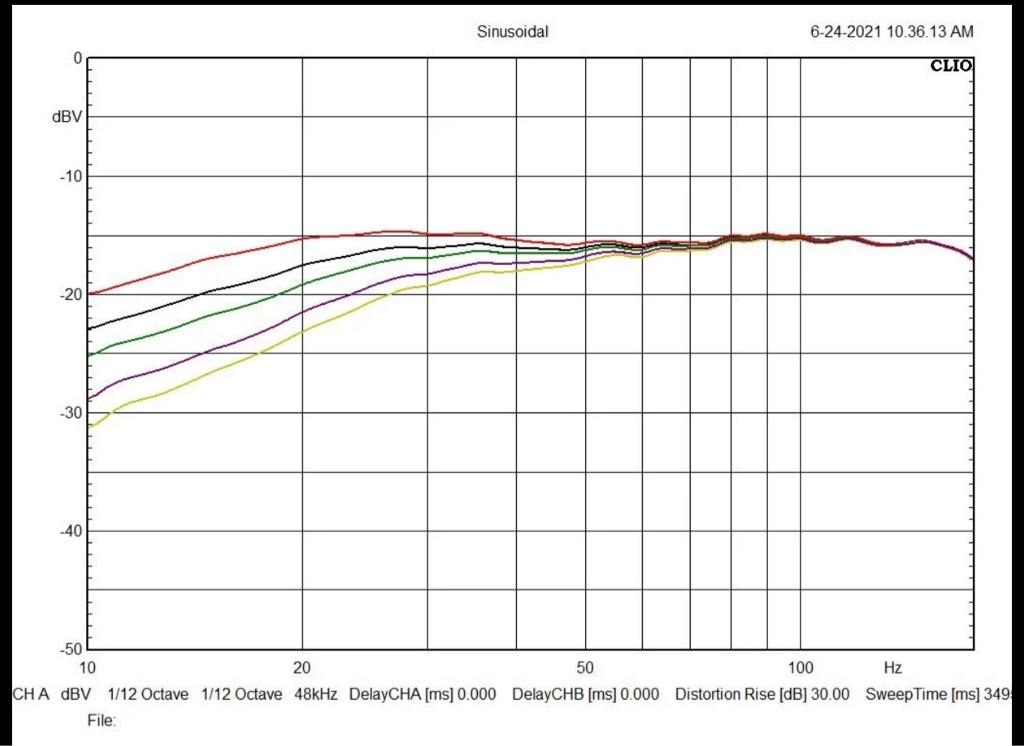

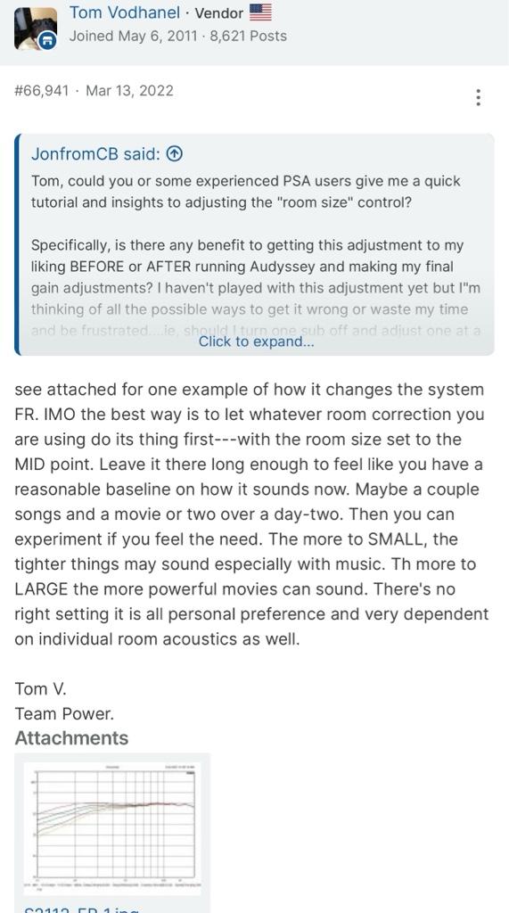

I wish there was an illustration that showed how the room size adjustments worked. Has that been well documented/explained anywhere? I think both are set to around the same as you. I’ll continue to tweak!

So I could find a couple things on a quick search. Here’s what the graph looks like.
Here’s Tom’s answer to someone. Hope this sorts it out.
