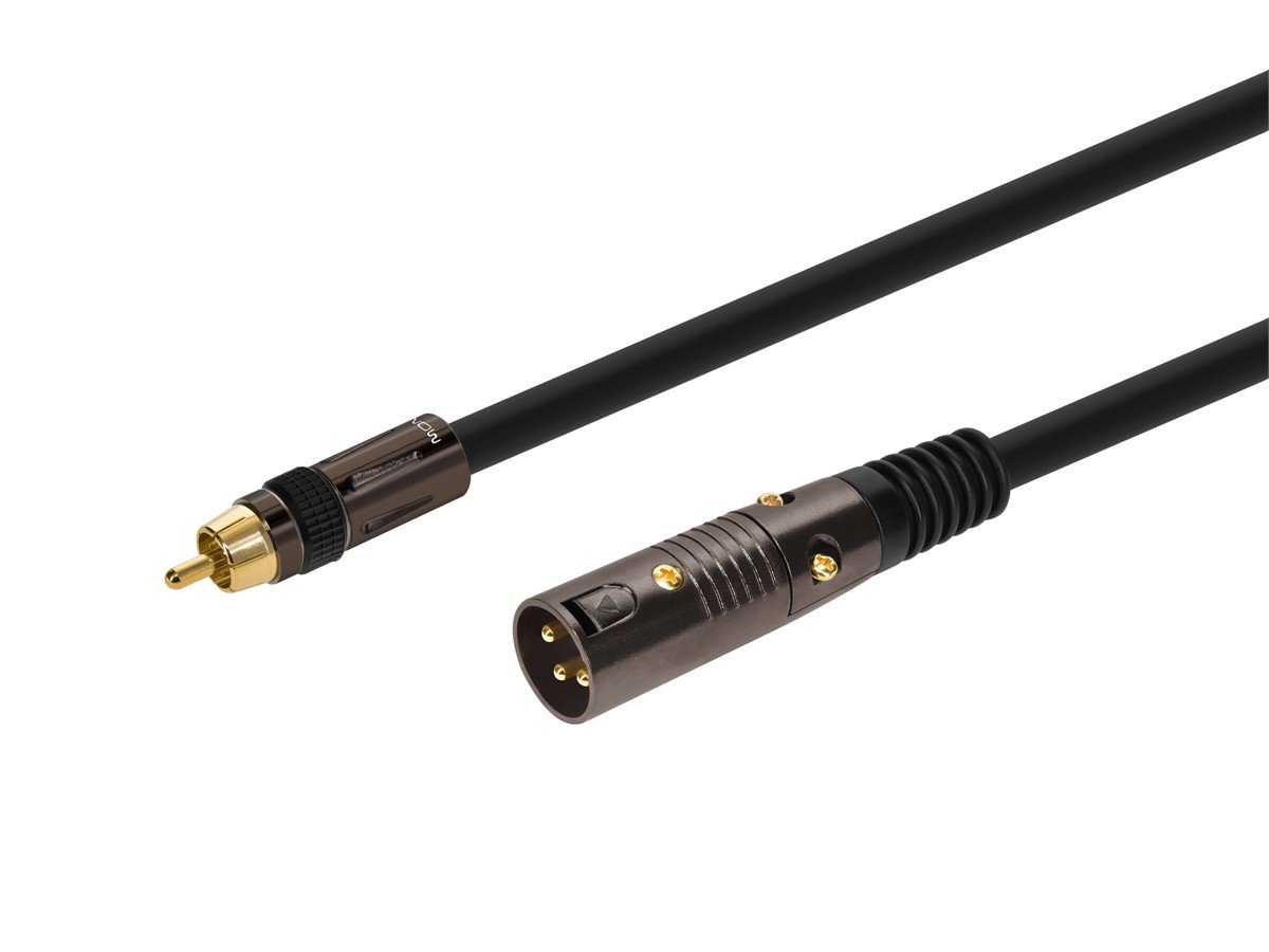

You can get adapters to go from XLR on the Crown to unbalanced RCA on the Luxman. That set up has promise ... and a phono input. :)
You can buy RCA female to XLR male adapters and use them with standard RCA interconnect cables:
or buy cables with male RCA plugs on one end and male XLR plugs on the other end:
One thing to keep in mind is gain. A balanced XLR connection typically requires double the voltage vs unbalanced RCA. No big deal if the Crown has a relatively low input sensitivity anyway, but something to think about.
