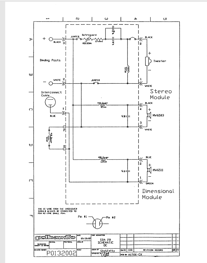

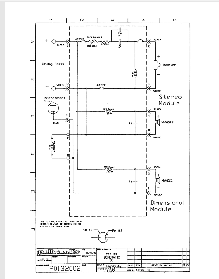

Here is a schematic of one of the older SDA speakers:
Basically it is pulling the sound information from just the positive terminal, which on a single ended output amplifier, is fine, all of the signal is present on the positive terminal of a single ended output amplifier.

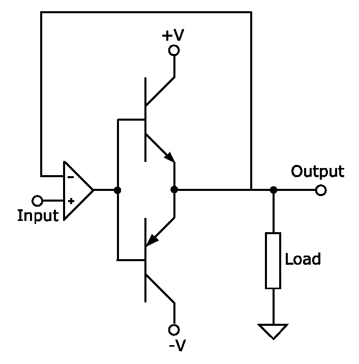

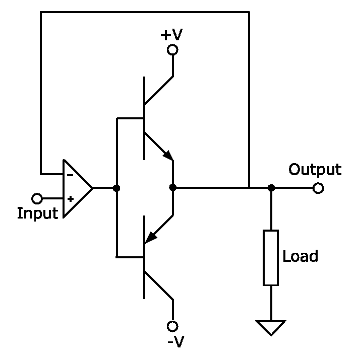

Here is a PP amplifier. You can see there is a positive output, load, ground. All the signal is on the output here.

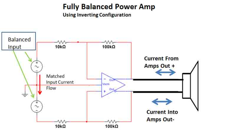

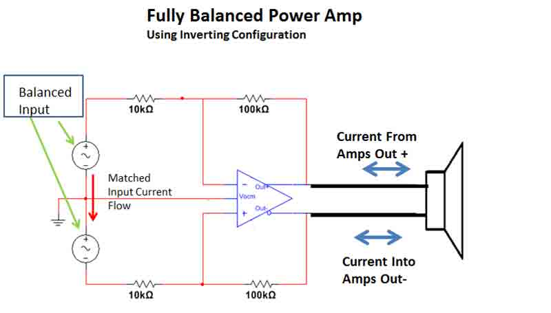

But a differential amplifier is different.
Half the signal is on the + output, half is on the - output. Go back to the rail voltage comment. To obtain the total swing, the sinewave isn't swinging up and down the full amount on just the positive output. Instead, half the voltage level is on the positive terminal and half is on the negative terminal, with inverted phase. That is what gives the total voltage swing. So for a given wattage of output, the stereo array speakers would only see half the voltage swing that the main drivers see, thus 6dB quieter.

The networks are extracting a "L - R" ambient signal (as opposed to normal stereo L + R) passively, a la the old Hafler dynaquad approach. That explains the need for the floating ground on the amp and extra wire connecting the speakers together. The positive amp terminals are connected to the networks/speakers, but the negative speaker terminals (on the drivers that recieve the extacted signal) are connected to each other, not the amp, hence the different power draw from the rails. Apologies for any incorrect technical terms.
Does that help clarify whats going on electrically?
You know I think you are right. I think this is not really sending out of phase output from the opposite channel. That would null the center information.
So in fact it probably is the old Hafler circuit used as "pseudo surround" back in years done by. I experimented with that and abandoned it smartly. It did have somewhat of a vogue. So what they are doing with these speakers is using that crude passive Hafler circuit to derive difference signal between left and right channels, and then feed that out of phase to the outside drivers of the opposite speaker.
Here is a good description of the Hafler circuit. It does explain why an amp without a true ground for at least one speaker terminal would not drive that Polk contraption. In addition the fact that it does not work with balanced output amps, gives the game away as you have correctly surmised. Very well done six2xpack!
