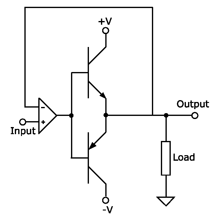

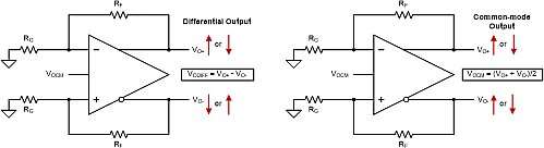

"Most amplifiers in general are single-ended output so finding a good amplifier that works is not a big problem."
Other than some weirdo Nelson Pass things, which solid state amplifiers do not have differential output stages? I don't think I've ever seen one, save some guitar amplifiers.
Your thinking of push pull. Push pull amplifiers are still single ended output. The pushing and pulling is tied together.
vs
The two diagrams at the end of your post are not of audio amplifiers per se, they are of op-amps (for the uninitiated, components or circuits sometimes used to construct audio amplifiers). All audio amplifiers meant to drive passive speakers have single-ended outputs by definition. Amplifiers with differential outputs in the audio world are pre-amps (or line-level components with XLR connectors). The purpose of using differential op-amps are to maintain the differential path from input to final amplifier output, so as to maximize CMRR.
Push-pull topology is not considered single-ended because it includes a phase-splitter. That's what the triangle with the +/- is in your first diagram. The two output devices operate in anti-phase. Audio amplifiers with a single-ended topology do not use phase-splitting.
I'm guessing your reference to ground comment must refer to the few amplifiers that use internal bridging and a floating ground.
I noted that single-ended amplifiers are not mentioned in the Polk owner's manual. How did you arrive at that conclusion? Did a Polk engineer tell you that?
lots of amplifiers have differential outputs in which the negative terminal does not reference ground. All HYPEX, Purifi, and various differential output Class AB amps are of this type. Your statement that all amplifiers are single ended is completely incorrect.
I came to this conclusion because the designer of the speaker told me about the issue. However others on this forum had raised the concern when I started reviewing and was using a fully balanced differential output Cherry Class D amp.
Matthew, I said the outputs, the speaker terminals, of all amplifiers intended to drive passive loudspeakers are single-ended. How can they not be? There are only two connectors, a positive one and a negative one. There isn't any anti-phase information at the output terminals. All levels of differential, dual-differential, or bridging circuitry are by definition electrically re-combined before the current reaches the output terminals. This makes speaker connections single-ended. Don't believe me? Ask Gene. The use of differential output stages are electrically transparent to speakers.
Having not seen the circuit schematics for, well, nearly all power amplifiers, I can't speak to which ones have floating grounds and which are earthed grounds. I also don't know exactly how the SDA circuitry is configured, which of course is a unique problem for Polk speakers. I didn't realize until this conversation that many (most?) Class D amplifiers have floating grounds (meaning there's a voltage offset at the ground terminal), because I don't use Class D amplifiers (well, except for integrated amps in the SVS and Velodyne subwoofers), so I didn't care. A simple search though turned up this page for REL subwoofers:
So, the floating ground messes up their circuit strategy for the REL speaker-level subwoofer inputs, and can cause damage. How quaint. I didn't notice any such warnings for my Velodyne sub, either in the owner's manual or on the web site, but that doesn't mean the vulnerability doesn't exist. I do wonder, however, if the appearance of significant voltage at the negative terminal of an amplifier's speaker output is the issue that the Polk engineers are talking about. Perhaps that reduces the level of the cancellation signal? I don't know. Perhaps Polk could send you a comment or post themselves.
Are you referring to this statement in the Q&A section of the DAC (Digital Amplifier Company) website:
Q: Can I connect my Subwoofer with the speaker level inputs?
A: It Depends. Maraschino amplifiers use what's known as a "Bridged Output Stage". This delivers clean, stable, high-current power to your speakers, but can not be used to drive some subwoofers with common-ground speaker level inputs. These share a connection to ground which would be damaging to your Maraschino equipment. Some subwoofers have facility for balanced power inputs. You can check this by using an ohm meter to measure resistance between the two negative terminals. As long as it has a very high resistance (something around 10Kohms or more) between the pair you'll be fine. Dual subwoofers with amplified but physically separate cabinets would be okay, too. As long as the amps can't see each other electrically, you should be fine. When in doubt, ask us!
This is the same ground-reference issue the REL site mentions. This has nothing to do with differential output stages, this has to do with DAC using a floating ground. The ATI AT3000 amplifier I use is essentially a bridged differential design internally, and now I wonder what grounding strategy it uses, not that it seems to matter to my speakers at all.
So I suspect that the real issue with the SDA circuitry is that it's incompatible with a floating ground amplifier. If so, it would be good to clarify and highlight this point.
You are still not correct. A differential output does not need a ground. There is anti phase information. Please read the article I linked to.
Irvrobinson
Irvrobinson
There is anti-phase information in the speaker outputs of an amplifier with a differential output stage? You're on your own, Matthew.
