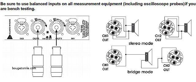

View attachment 50955View attachment 50956View attachment 50957
This should help.

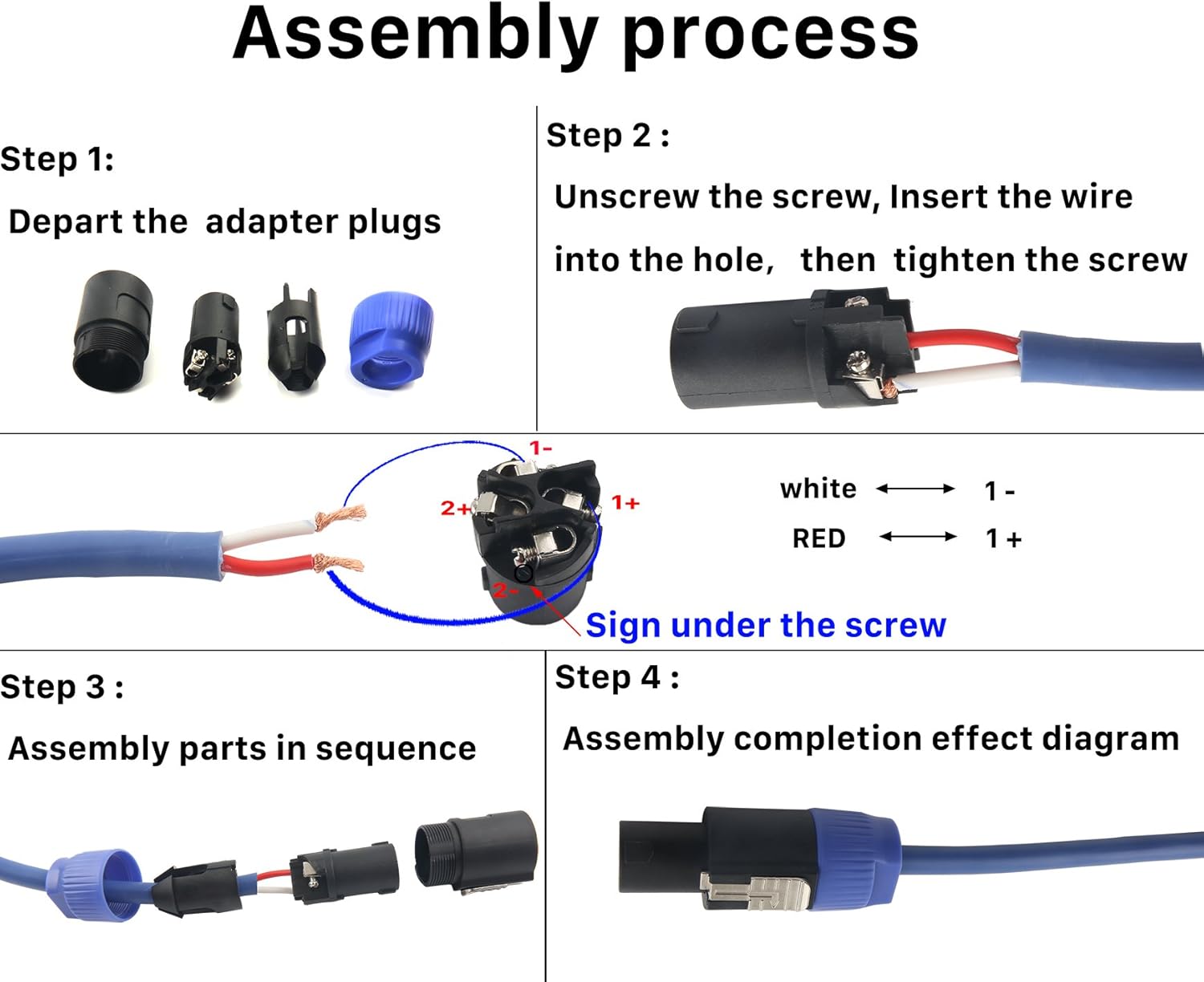

Short answer is yes and be sure to maintain the correct polarity. What ever pin they use for the black wire that is on your negative speaker connection, do the same. You don't want to switch the ends and change the phase.
Like those guys said, if the current wiring scheme works, just copy it over to a new cable. Was your connector soldered on or just screwed down?

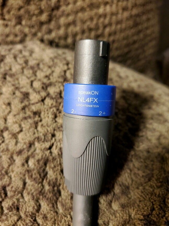

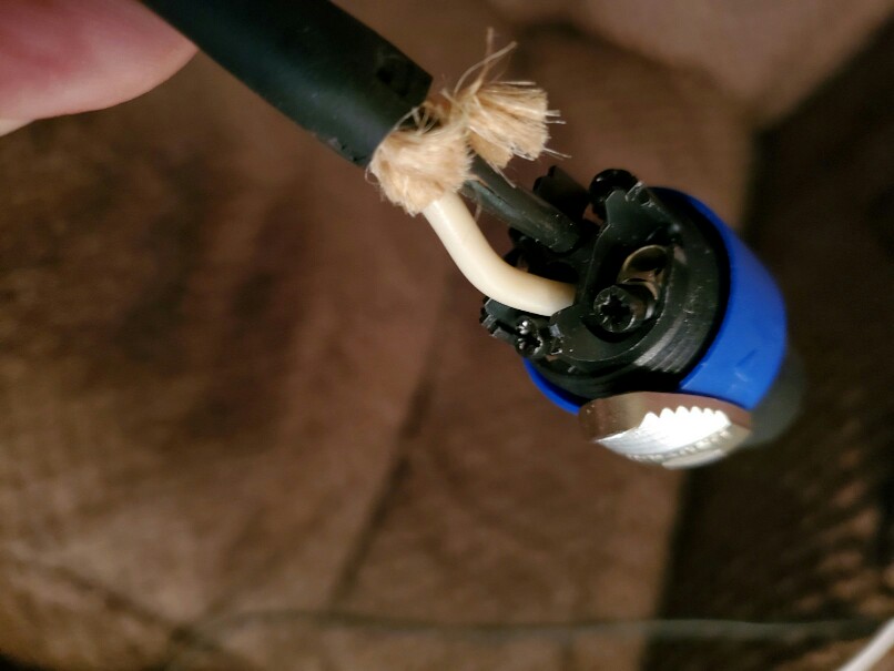

This is so aggravating... how in the hell do you take these apart?? Do they snap together? Screw together? I'm not making any headway and I'm afraid of breaking something.
*PS, got it. It's threaded, but it was super tight.

Judging from panteragstk's photo, you use +1 and -1 for the + and - terminals, but if you have 4 conductor cable you can double up the wires and use both the 1 and 2 connections. This would be more common when you have speak-on on both ends; not so much when using banana plugs or spades on the other end unless you use both sets or binding posts on the speaker. Gets more complicated when you use two amplifier channels in bridge mode but I would refer to the amp manual for that. Pretty straight forward if you're just duplicating what was working before. If the connection was soldered, tin the ends of the new wire with solder before soldering to the speak-on connector. Makes it go a little easier.

I did get it apart tho, and there's no solder. Looks very straightforward. Just don't mix the polarity. Piece of cake.
