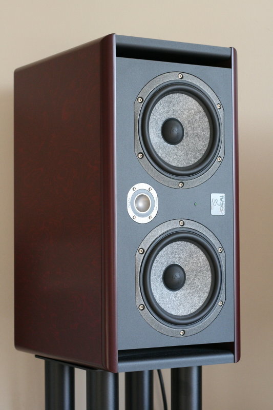

The disadvantage of placing a slot or port on top is usually the tweeter (or mid-range and tweeter in a 3-way) is located at the top and you would be much more likely to get port leakage of sounds from these higher frequency drivers!
Here is an example of a speaker with a slot at top and bottom, but the slots are as far as possible from the tweeter! You can see that using round holes on the front would force the cabinet to be taller than it otherwise needs to be.
The drivers are probably in their own cavities.
Great question. And another thing, the placement of the rear ported speakers is something that is taken as a sure disadvantage, so what about the speakers that have a "downfiring port" (on the bottom of the speaker, facing down in a tower type speaker, meaning it will hardly ever get far from the surface):
I think that is a Polk LSiM707. The drivers, which incidentally seem based on the old KEF B139 design, are tuned differently. One driver looks to be a conventionally ported alignment, the other seems to be some type of coupled cavity tuning.
Polk love these complex tuning arrangements, which to my ears are not successful. The idea is to extend the frequency over which loading is assisting the drivers. I have never heard one of these improve, things, in fact to the contrary.
If you really want to do that, then a properly designed reverse tapered and damped TL is the solution. That does get you the desired result.

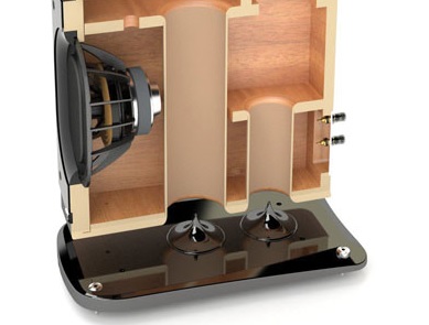

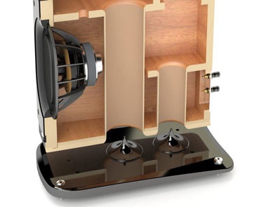

I've seen these in some Fostex speakers.
