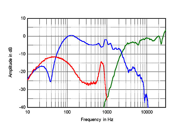

For those interested, here is an example of what port resonance can look like in a frequency response curve. The speaker is an expensive ($3800/pair) 2-way bookshelf speaker with a front-mounted slot port. The measurements are from Stereophile.
The red trace shows the output of the port, with a prominent peak centered at roughly 700-800 Hz. This peak is about 10 dB quieter than the mid woofer's output at that range, and I'd expect, it can be heard, depending on the volume and musical content. In this example, the front-mounted slot port doesn't seem to be worth the effort.
I expect most speakers to have quieter port resonance, at least 20-25 dB below the mid woofer. If the port is rear-mounted, port resonance should not be heard.
The red trace shows the output of the port, with a prominent peak centered at roughly 700-800 Hz. This peak is about 10 dB quieter than the mid woofer's output at that range, and I'd expect, it can be heard depending on the volume and musical content. In this example, the front-mounted slot port is not worth the effort.
I expect most speakers to have quieter port resonance, at least 20-25 dB below the mid woofer. If its rear-mounted any port resonance should not be heard.

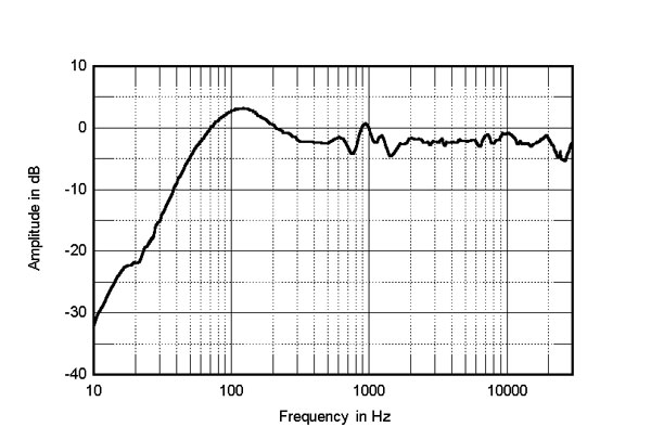

Aside from the bass hump, the aggregate is a pretty nice FR... if you don't include 500-2,000Hz!:rolleyes:
We have to keep in mind that the close mic testing that Atkinson does will exaggerate the bass frequencies. If that speaker was testing in the anechoic far field, that hump centered just above 100 Hz would not be as elevated.

Strangely enough, his port measurement stops right around the frequency range where a peak could develop. Is there a peak at 700 or 800Hz? How would we know?
Good observation!!!
If there was a significant amount of output from the ports in that region, it would have shown up in the far-field measurements, but they don't show anything like that. It there was a peak, it wasn't enough to make a difference.

True (although depends on one's definition of 'significant'). But it's still strange that he plots the port output to 1kHz for some speakers and only to 500Hz for other speakers. If you look at the response of the B&W midwoofer, you can see a dip right around 1kHz. Is that where a (smallish) port resonance occurs? Maybe.
