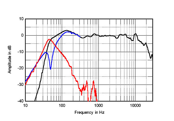

Strangely enough, his port measurement stops right around the frequency range where a peak could develop. Is there a peak at 700 or 800Hz? How would we know?
Good point. I chose that plot as an example of a properly performing port, but I didn't notice the plot stopped at 500 Hz.
Swerd
Swerd
Beave's sharp eyes noticed the absence of frequency response info above 500 Hz for the port (red trace) on these speakers (B&W 805 D3). Thanks :). The more I thought about it the more I wondered why. B&W uses large diameter flared ports covered with highly noticeable dimples, said to "smooth the flow of air". Why would a magazine review of the speaker omit information that could illustrate that? Is it no better than a non-dimpled port? Is it worse?
Any way, I looked for another example of a ported 2-way speaker where the port resonance (or noise) is shown up to 1000 Hz, and it is acceptably low. Here the red trace shows the port noise is more than 25 dB quieter than the speaker.
Beave's sharp eyes noticed the absence of frequency response info above 500 Hz for these speakers (B&W 805 D3). Thanks :). The more I thought about it the more I wondered why. B&W uses large diameter flared ports covered with highly noticeable dimples, said to "smooth the flow of air". Why would a magazine review of the speaker omit information that could illustrate that? Is it no better than a non-dimpled port? Is it worse?
This should not surprise. A port is an open pipe in organ parlance, and so it will contain a half wavelength at resonance.
It will radiate even harmonics at decreasing intensity.
So the port will resonate at a frequency of the speed of sound divided by the port length X 2
So if we take the speed of sound as 1,100 ft/sec. A 5.5" port will resonate at 1000 Hz.
So if the speaker inside the box is radiating sound at 1000 Hz the port will resonate.
I do put damping near the port and behind the driver. The only way to stop it totally is to have the driver crossed over well before port resonance. That is not going to work for two ways.
So we are talking here about something inevitable and expected.
However it does have to be considered a disadvantage of ported speakers, although not a big one.

This should not surprise. A port is an open pipe in organ parlance, and so it will contain a half wavelength at resonance… …
Thanks for that helpful explanation, especially the illustrations.
However, it makes the absence of port frequency response data for those B&W 805 D3 speakers more puzzling because the crossover frequency of these 2-way speakers, 3300 Hz, is well above the expected port resonance frequency of about 1000 Hz.
Something in John Atkinson's text (Measurements page, below figure 2) does partially address this question:
"The impedance-magnitude trace suggests that the large, flared port on the front baffle is tuned to 50Hz or so. The minimum-motion notch in the woofer's nearfield output (fig.3, blue trace) occurs at 48Hz, and the port's response (red) peaks between 35 and 90Hz in classic fashion. (I haven't plotted the port's output above 500Hz, as the measurement at higher frequencies was contaminated by the woofer's output.)"​
What Atkinson says in print is almost always factually correct, but at times I've found that what he doesn't say can be more important. Maybe I am being too skeptical, but I feel like I need a lawyer to help me read statements such as I quoted above. Perhaps (this is entirely my speculation here) this statement was the product of negotiations between B&W and Stereophile about what to say about an undesirable result of Atkinson's measurements.
It's strange. I can't figure out why the port output measurement would be contaminated by the woofer's output in this particular speaker; while in several other front-ported speakers with similarly close woofer and port placement, he was able to get a clean measurement to 1kHz.
It would be a good question to ask him.
The answer is simple and obvious. The port is very large in diameter. The bigger the hole the more sound will come out from inside the cabinet.
B
Beave
But then why wouldn't he should show that in his measurement, as he does for other similar speakers?
I get the impression that he's saying he cuts the measurement off at 500Hz because his measurement is getting contaminated by the woofer's output firing outward, not inward into the cabinet and then out through the port.
I believe TLS Guy is right. Depending on where the port is situated and its configuration, you can hear the output of other drivers through the port. Atkinson may have cut off the measurement at 500 hz because the port wasn't actually generating the output being recorded above that; the woofer was. Myself, I would have left it in the measurements- it is energy being generated by the speakers, who cares how that happened. But you have to keep in mind that sound that leaks through ports like that isn't going to be audible, unless you listen to the back of the speaker instead of the front.
Isn't that all the more reason to measure it? ...to ensure it is not excessive?

The point I would have thought was obvious. The leakage from the port is just one of multiple sources of leakage of sound from the rear of the cone out through the enclosure.
So showing the port leakage would be misleading and NOT be a valid comparison by itself to the total leakage of the speaker under test and other similar speakers.
