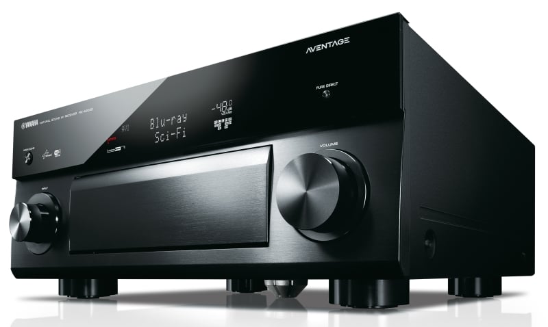

My receiver is a 2015 RX-A2040. It has Atmos capabilities.
This is what I have. Mine is the model RXA2060 so almost the same.
Running 5.1.4 with front and rear presence and I use DSU on everything to upmix.

So, do you have side/rear surround sound speakers, or are they not needed with the front/rear presence speakers?

5.1 base layer
Rears are to the side on walls
Front and rear presence on front and back walls
Consists of:
Canton 836
Canton 556.2
Canton 516.2 On Wall
Canton AR800 Front Presence
SVS Prime Elevation Rear Presence
Rythmik LVX12 Sub

Definitely needed.
Just so I'm getting this straight then:
L/C/R
Subwoofer(s)
Side Surround L/R
Rear Surround L/R
Front Presence L/R
Rear Presence L/R
So that's an 11.2 set up. Which my receiver doesn't support, only 9.2
Also, maybe I'm reading it wrong, but my understanding was that the front presence speakers once turned on in the modes they operate in means that there will be no sound from the rear surround speakers anyway.
snakeeyes
That’s correct. On that model 2040, if you use the 4 for Atmos you lose the surround back.
It’s 9 channels total. Same with 2050/2060/2070/&2080.

Should be able to use an external amp via pre outs though correct?
FWIW, I would rather do 5.1.4 than 7.1.2.

So what, if any in your opinion, is the advantage of having the 4 Atmos speakers vs having side/rear surround speakers?
I guess what I'm getting at/trying to figure out is if I need to buy the Presence speakers at all, or just stick with my 7.2 set up I'm running currently.

Well you wouldn’t have either/or. You have 2 or 4 height/presence/Atmos speakers AND bed layer speakers be it 5ch or 7ch. That’s how we get to 5.1.2, 5.1.4, 7.1.2, and 7.1.4 etc.
IE: 5.1.4= 5 satellite speakers(bed layer) .1 lfe channel, .4 height layer.

I would definitely want 5.1.4 over 7.1.2 or 7.1
Having 4 Atmos speakers is a lot better than 2.
I definitely don’t miss the surround back.
