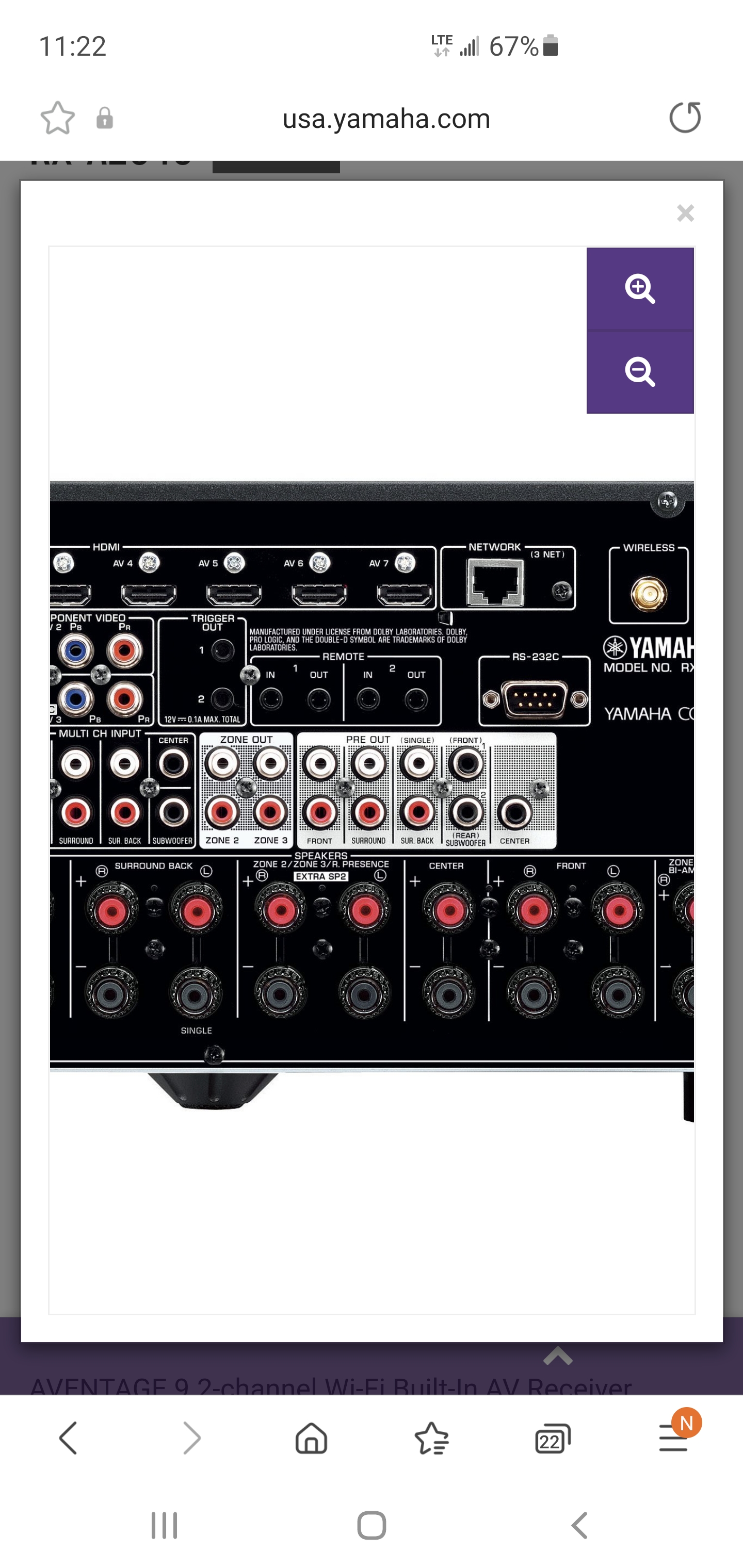

I thought adding another amplifier would add more channels? Is that not the case? Here is a picture of the back of my receiver:

So, by plugging in the 2nd amp to the pre out of say the surround back, would that not re route the audio signal through the 2nd amp, allowing me to then also use the Front Atmos as well as the rear surround speakers, creating a 7 (L/C/R, Front Surround, Rear Surround) .2 (Subwoofers) .4 (Front and Rear Atmos/Presence)? Or would the 2nd amp not matter? Is my receiver limited to the 9.2 channels no matter how I run it? IE 7.2.2, 5.2.4
It’s confusing mostly because they share the same manual 2040 & 3040.
The 2000 series allows you to wire it and flip back and forth to different 9ch layouts (no preouts function for Atmos front or rear) however it can only process signal for 9 ch at a time even though 11 are wired. So that means 5.1.4 or 7.1.2
I would love to be wrong on this but I’m 95% confident I’m correct.
So imo, he should move his rear surrounds up into rear height position, and get another pair for front height duty. Make sure the surrounds are at ear height and have a nice 5.x.4 system. Until the AVR upgrade...
Ok, that makes sense. After thinking about it, I was thinking that was the case. It can only process 9 channels of audio no matter what. Adding an additional amp simply draws the power needed from the 2nd amp, but doesn't create additional audio channels.
