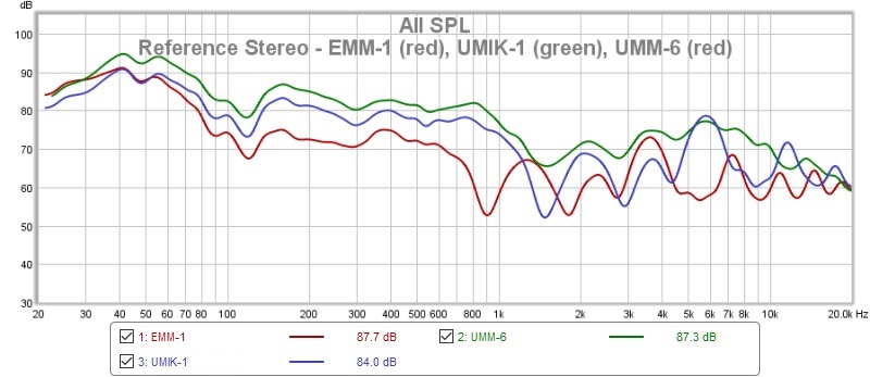

Measurement positions and MICs make a huge difference, especially above the transition frequency.
Here is a smoothed comparison of 3 of my MICs made a while back using the XMC-1 Reference Stereo (no processing).
I don't recall the smoothing but there is correlation that falls apart at higher frequencies,
Auto-cal may do a better job on the measurements, however, I preferred PEQ which had less impact on the soundstage.
I don't recall the smoothing but there is correlation that falls apart at higher frequencies,View attachment 24930
