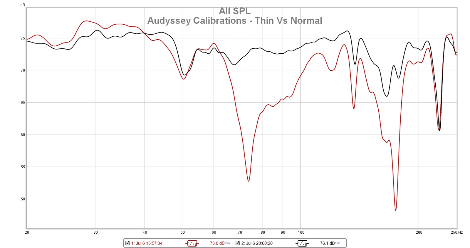

I tried the X3400H for almost two weeks, like it's performance, the look, the weight and the cool operating temperature. Replaced it with the X4400H only because I wanted to try Atmos in the near future, hopefully. This thing runs much warmer.
Both units sounded incredibly well with 2 channel music whether I used digital or analog inputs, so I expected the X4400H to perform well in my HT room. It was late in the evening after I sorted out the wire jungle behind the wide and heavy cabinet, so only have time to run Audyssey quickly, and just once from the AVR; and started scanning a couple of shows on Amazon and Netflix.
To my surprise, the DD+Dolby Surround (versus AV8801's DD+PLIIx) sounded different, or "thin" and seemed to have less dynamics. I didn't panic because that's not how it sounded in the two channel system, and from experience, I know how Audyssey could make things audibly worse if not done right. It was really late, so I went to bed, knowing that I would have to play with Audyssey calibrations some more the following day.
So yesterday I re-ran Audyssey, using the App this time, plotted some graphs to compare the first AVR run and the second App run and plotted bunch of graphs for different combinations of XO. It took a long time to get enough graphs for analysis later. It was late again by the time I got enough graphs. I couldn't wait to find out about the new sound as I could see the different FR in the graphs already. I thought I should watch that same show again before I went to bed.
Below are the graphs for the two calibration runs, for the FR+FL+Subs.

So "Thin" is the RED graph that lacks bass from 65Hz-100Hz?
When people say "Thin", I always assume it lacked bass.

Sorry to hear about the problems :(
I would assume bottom end/bass general for thin rather than a lack of shall we say impact. You are indicating the graph is for both sub and front LR, correct? The +10db dips around the 180Hz and 230Hz will have a real bearing on it sounding thin if we assume the crossover is @80Hz for the main pair.
Yes, I rushed that run so something got messed up I suppose. After the second attempt, the x4400h seems, just seems,
to sound warmer than the Marantz. I am hearing bass that I haven't heard before, not an AB, so very subjective for sure.
It's not a really a hardware or software issue, but an operator issue.
Yes, it was 2.2, the 7.2 plots were flatter. Crossed at 90 Hz (red) and 80 Hz (black). The black would have looked a little flatter if crossed at 90 as well.
It sounds fantastic now, without any editing, yet..

You think Audyssey just decreased the Subwoofer level too much on the first run?
I've seen people c/o the lack of bass after applying Audyssey and other room correction. I think most people have to boost the subwoofer levels anyway to their preference.

I can't imagine any speaker/room combination requiring that sort of treatment. Both curves have that insane dip just below 250 Hz.
I would listen with everything Audyssey shut off for a while. Audyssey is based on worse than dubious science, poorly executed and a guaranteed quality spoiler. Nothing will shake me from that opinion. Keep running curves and see what a weird collection you get.
It could be many reasons, including the background noise at the time. My HT room is on top of the garage that backs into a narrow street, you know one of those that has garages on opposite sides. So if say, when the subs and mains are getting the chirps, some noisy cars drove by slowly, the stupid thing might think there was a bump in the bass. It is hard to figure out, that's why I always checked with REW after. Boost won't work if applied globally.
That dip is basically gone when all 7 channels and subs are firing so looks like Audyssey has done some balancing act to cover multiple scenarios. With Audyssey off the curves are much worse, below is one for the left and right channel, no sub. The Denon's are very similar, though done in different times so the mic positions won't be exactly the same and the speakers might have been moved a little.
Note that smoothing is 1/48, I think that's appropriate for below 1K hz. I would love to see your speakers's in room responses, I am sure they are better speakers than mine.
