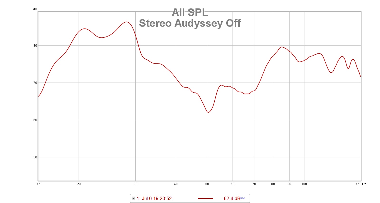

Below is from just one attempt, without using the Editor app yet, and no smoothing at all. I could never get it that good using REW and mindsp. After editing, I should be able to improve it further by 1.5-3 dB, I know so because I tried it already in my two channel system. The red one is with Audyssey turn off, so no TLSGuy thank but no thanks.:) Note that the Audyssey off one already looks better due to the axis scale of 10 dB per division vs the 5 dB/division for the Audyssey ref curve.
So, if you recommend turning off Audyssey, what methods, procedures and/or products do you recommend for EQ?
As I said before, I do not use any room Eq, and personally I don't think most rooms need it.

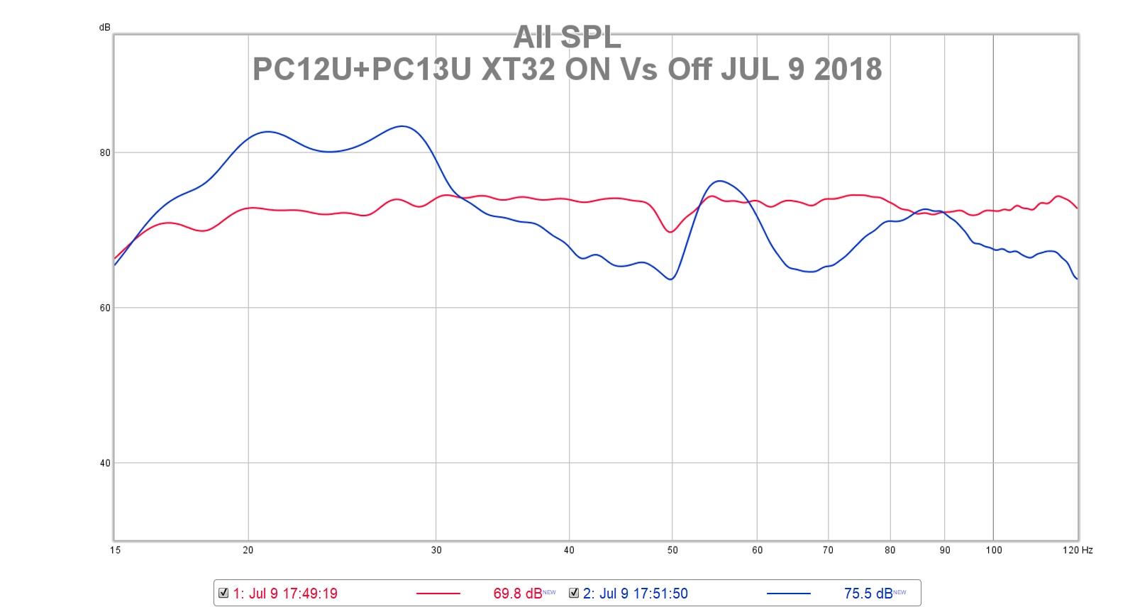

Gents, the graphs below are without any smoothing, anyone can tell which one is XT32 Off, right??
Hello RichB, your experience using REW/PEQ and XT32 seems very different than mine. So far I have used XT32/X3400H, XT32/X4400H, REW/PEQ/minidsp in my LS50/R900 2 channel system and the 7.2 HT system, and found that the best I could manage using REW/PEQ/minidsp was to equal what was achievable using the XT32/AV8801 but the XT32/X3400H and X4400H are able to do a slightly better job, without using the Editor App to change the target curve. I just plotted a few more graphs for the subwoofers only scenario.
The phase graphs actually look better with XT32 on, than with it off, same for the impulse. I don't think I will take the minidsp 2X4 HD out of it's box again.:(
The reason I decided to plot more graphs last night is that going by memory I thought the bass sounded better in both Amazon/Netflix movies and live concert BR so I wanted to see what's going on. The curves definitely look flatter than those I plotted when the AV8801 was in place, it looks like a case of quality over quantity. I plotted those for the FL and FR too. In all cases XT32 improves the low frequencies a lot. I am thinking of shooting a video next time I run XT32 again.
@ADTG, I think you are right, some people do not prefer flat FR, not in the bass area anyway.:D:D
The red one has to be Audyssey on. It’s way too flat. :D

For those who wonder about the axis scale, yes I did try to make it 5 dB per division instead of 10, but then it wouldn't fit the screen, and I still have not figure out how to make the fonts larger. I could make it larger on the screen, but as soon as I use the photo capture function, the saved JPG file would default back to the small font size regardless. Does any one know how, before I PM the creator John M or post the question on the Hometheatershack forum about it?

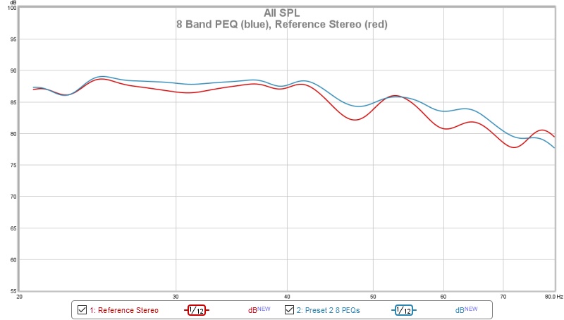

Here is what I was able to achieve in a ½ hour to flatten the bass to within 5 dB between 22 Hz and 75 Hz (of the intended curve).
The sound stage was not significantly altered by these PEQ settings.
It seems odd that speakers with reasonable phase performance properly placed would out of phase.
I suppose room interference can cause cancellations and late reflections, DSP processing can definitely alter phase.
I remember reading somewhere that the MiniDSP 2x4HD introduces about 4 milliseconds of delay. Whereas, their Dirac products can introduce up to 40 milliseconds of delay.
This is why I always compare PEQ/REQ to Pure Direct with trims adjusted (as best I can) as a reference.
- Rich

I was able to do better than that with REW, but XT32 got me with 5 dB from 18 to 110, before I even touch the editor. Different room, different speakers so hard to compare for sure.
So did Dirac do worse for you, compared to REW/minidsp? I am going to try its Stereo version soon.

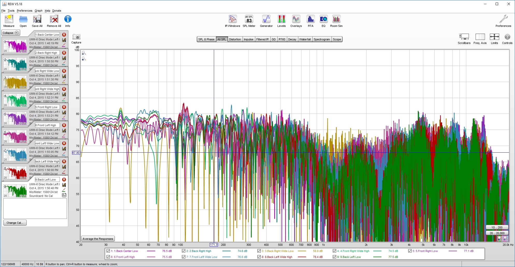

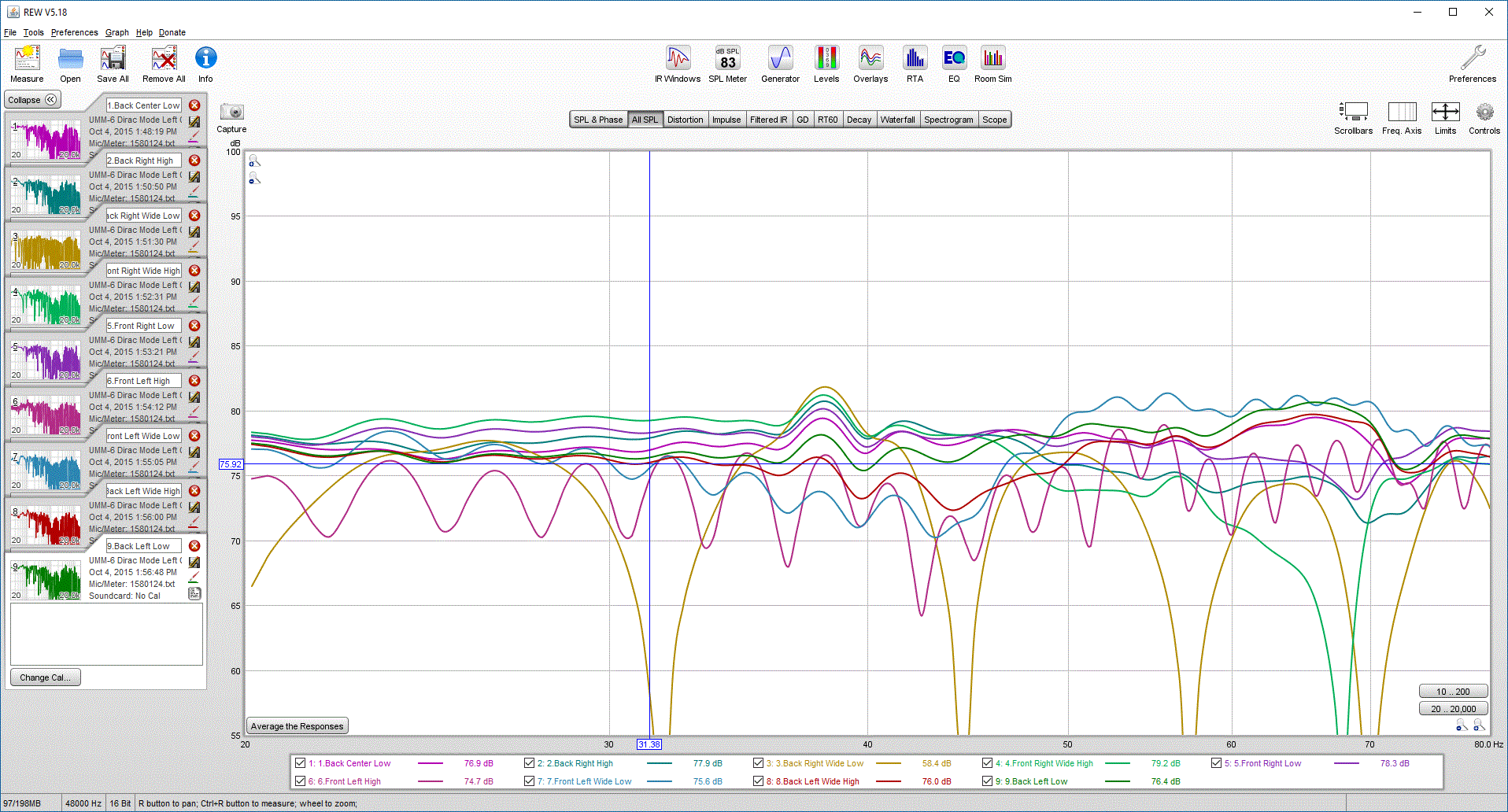

Here are is a chart for the 20 to 80Hz showing all 9 Dirac positions which are cube 2x3x4 representing my couch.
This is the UMM-6 calibrated MIC measurements.
On the left you can see the thumbnails.
I can smooth the charts and seem clear patterns but different MICs show different dips.
Here is the same data from 20 to 20kHz:
Even when smoothed, there were significant difference above the transition frequency with different (calibrated MICs).
After many, many hours of measurements, I decided to follow the Harman recommendation to limit correction below the 100Hz which had some consistency between MIC and measurement sessions.

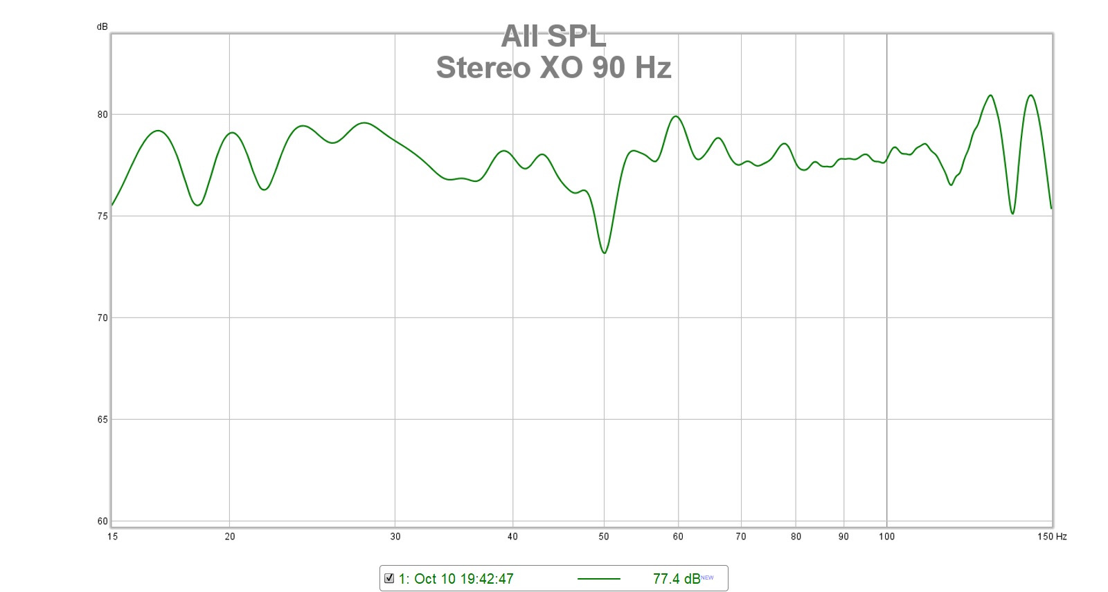

I typically use no smoothing for frequencies below transition and 1/12 for above and the graphs I posted are with no smoothing at all. It is strange that we have opposite results, i.e. manual EQ (REW/PEQ/minidsp) works better for you, and auto REQ (only Audyssey so far) works better for me.
If I understood right Dirac Live has a free 30 day trial, that should give me enough time to find out if it works well in my rooms too. If the PC/Mac version is in fact available for the free trail then I am going to do for sure, and soon.
