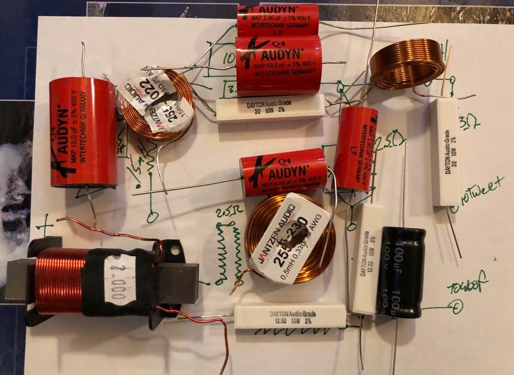

I’m laying out the XO boards and keep running into a situation with a 2mH steel laminate inductor and a .5mH air core in close proximity.
In light of the Air Core post earlier in this thread (Troels Gravesen’s guide) my question is how does a solid cores magnetic field operate?
Does the coil of the solid core inductor operate by the same principle, therefore allowing me to place an air core near and on its flat side (or near and standing upright at 90°.
I will post some photos in a moment to illustrate the question.
Thank you!

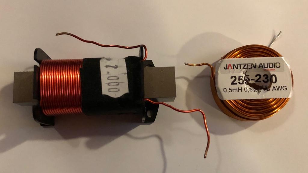

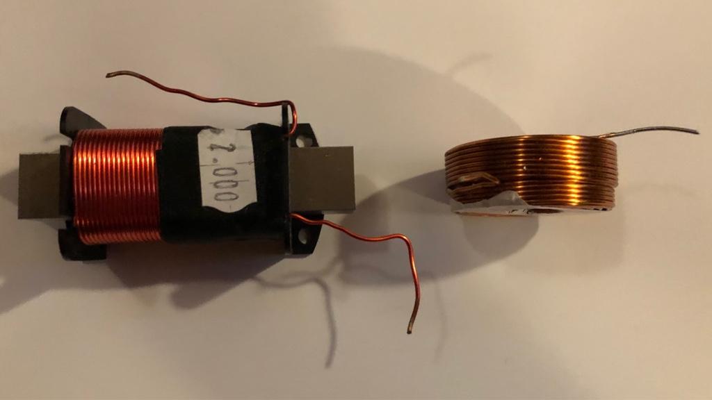

So first is just a rough placement... couple resistors and a cap are missing.
Then the two options I described above, spacing is about 1” (my index finger) and is about as far as I can move it on the rough in above.
Thoughts, please.

If you put 2 inductors close one from another, you definitely won't get a good result. But why use a steel laminate inductor when an a 2 mH air core coil is not that expensive? The air core inductor operates in a more linear fashion than the steel laminate and I was once shown proof of that at Solen's. Solen makes about the best air core inductors on the market and are used by some high end speaker manufacturers.
For all practical purposes, inductors should preferably be at least 2 inches apart. When inductors are a bit too close, one should be installed perpendicular to the other to counteract any possible interference.
