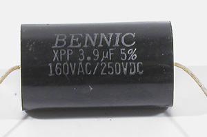

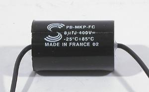

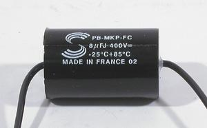

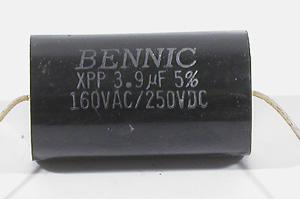

More info on the subject of capacitor voltage ratings:
Bennic caps – metalized polypropylene (MPP) caps made in Taiwan & sold by Madisound
Rated voltage: 250 VDC and 160 VAC
Life Test: 150% of rated working voltage at 105°C for 1,000 hours
Solen MPP caps
Test Voltage: 1.5 × rated Voltage for 5 sec.
Rated Voltage: 400 VDC and 250 VAC
Solen MPP caps
A lot of major speaker manufacturers have used Bennic caps over the decades,
FWIW, the Dayton house brand MPP caps, are said to be made in Taiwan by Bennic, under contract to Parts Express.
I've always treated Dayton and Bennic MPP caps as interchangeable equivalent products.
