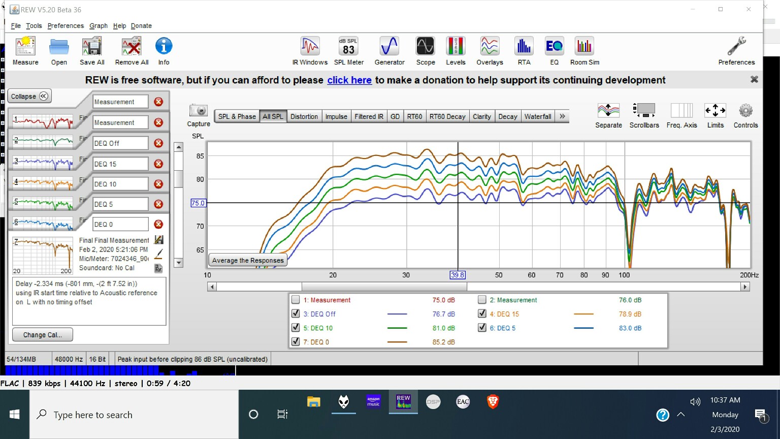

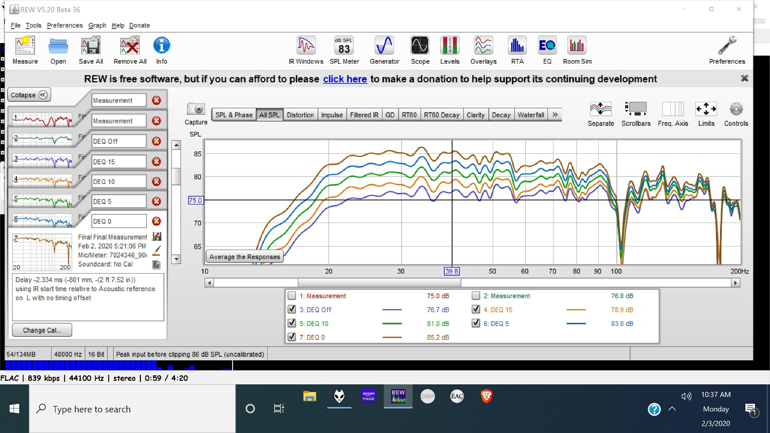

It sets where DEQ kicks in and how hard. RLO 0 would be the most aggressive and -15 is the lightest touch.
You know what? I have actual measurements and can show you exactly what it does!
You can see there (sweeps are all labeled) that DEQ Off is a flat response. DEQ is basically a house curve and the offset levels are how aggressive a curve you prefer. I'll switch to 0 for movies and -10 or -5 for music.

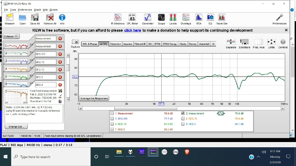

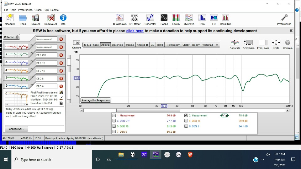

XT32 does its best to get it to this.
That sweep above is after I did some tweaking to what Audyssey did, with a MiniDSP. Then I open both ports on my subs and turn DEQ on as my house curve.

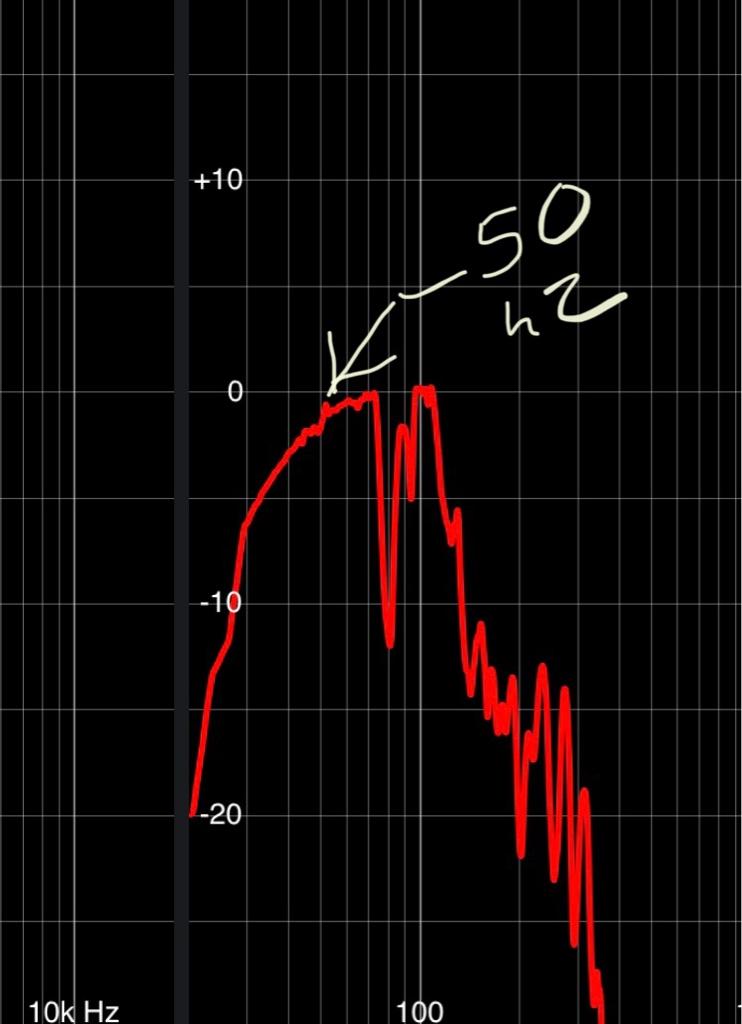

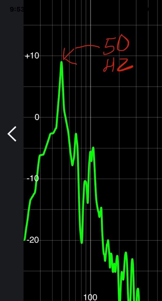

I think one problem with the sub response is that big peak at 50hz.
I think maybe Audyssey saw the back side of that peak as the -3 point and is rolling off the response below that.
This is absolute conjecture on my part but the specs down to 20hz. I know it’s sealed, but rolling off at 50 is crazy. Obviously the “after” is a calculation, but something is weird.

I tried to move the sub to the corner next to the couch. The graph looks better, right?
If I enable DEQ and turn up the level of the sub then I definitely get enough bass. So I think it's mainly now a matter of striking the right balance. It would be awesome if you could automatically adjust DEQ depending on the type of content you are listening to.
