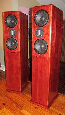

HOLY COW, what a difference the stuffing, port, and woofer seals made!!!! I was honestly a little disappointed when I first heard these, but my goodness did that ever make a difference. W/out it they were too boomy when they shouldn't be, and sounded like they had bad mids (probably cuz the mids were being drowned by the drawn out bass). They're all good now :D
I'm even a day early :cool:! Tomorrow I can sit in front of these and enjoy. Hauling them to Meniscus for the show on Saturday.
Matt - Those are really excellent results. Thank you for all the photos of your build.
I'm also very glad to hear how they sound now that the cabinets are stuffed, ported, and sealed properly.
Have fun at Meniscus and let us know all about it.

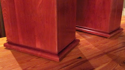

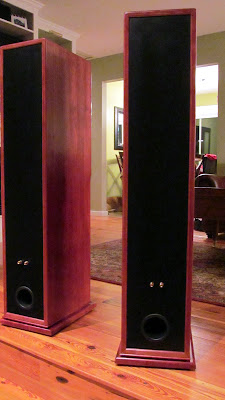

I'm in LOVE w/ these ER18s! I sat in my garage (yes, they're still in the garage :() listening to some Cat Stevens, then the Temptations, then some Fernando Ortega. I've listened to Fernando Ortega many times, and on one of his tracks called City Of Sorrows I heard a ucalaly for the first time :D. Thanks once again for the spot on build recommendation!!
Now I think I'll build a small cherry bar in the room they're going in to complement the ER18s. They deserve it :cool:
Grills :). Tomorrow I'm going to completely disassemble them and polish them. Then I'll take some good pics. Then they go in their rightful area :cool:

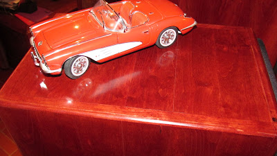

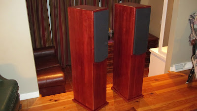

So, at this point you guys are probably getting pretty sick of me posting pics of these :rolleyes:, but I took some good ones last night and figured I'd share.
The finished product...
Matt – Thanks for the photos. I haven't got tired of seeing them yet :D. They really came out nice looking. Your excellent wood working skills and hard work really paid off.
