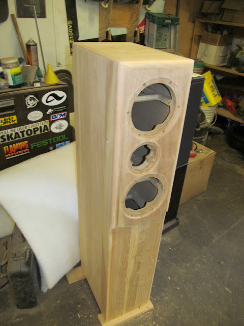

As far as the strips, it has potential but I'll never do it the same way again. I made the strips for the front 1/4" thick and they were pretty simple; just brush Titebond on and clamp away. I made the strips for the sides about 3/32" thick and those weren't quite so user friendly :mad:. Once I brushed the Titebond on they wanted to curl in a bad way. So I had to hurry to try to get all the strips brushed and laying on there so I didn't have a big mess. It worked, but I'll be sanding these till the new millenium. Going forward, when I resaw veneer, 1/4" is as thin as I'd like to go.
It's an interesting look, elegant meets rustic. Can't wait to see how they turn out once I get them all sanded and start brushing the blond shellac on!!

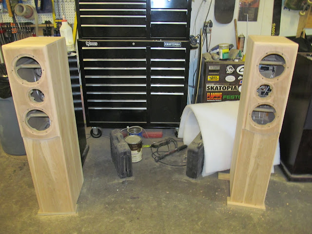

More done. Tonight I hope to get the tops routed w/ my flush trimming bit, then I'll be sanding til kingdom come.
Finally, they take shape!
First I hit these w/ some 80grit on the belt sander :eek:, then went over them w/ some 100 grit on the RO sander. Still have to hit em again w/ some 150, then again w/ some 220; but I'm going to put these in my basement for this coming week while I'm on vacation. It's a muggy 92 degrees in my garage, and a dehumidified 78 in my basement. Anyone that's done hardwood flooring knows what a disaster that can be when it comes to environment changes and wood (expanding and contracting). Hoping its not an issue, but I'd hate to spend all that time w/ finish and find out it is.
Very happy w/ the way these turned out. I have to honestly say I was pretty worried, soooo much work for this to not turn out!! I still have to make the cherry bases. I'm kind of torn on making a regular base w/ the shadow peice, or getting some cherry claw feet like you'd find on a Kindel chair.
