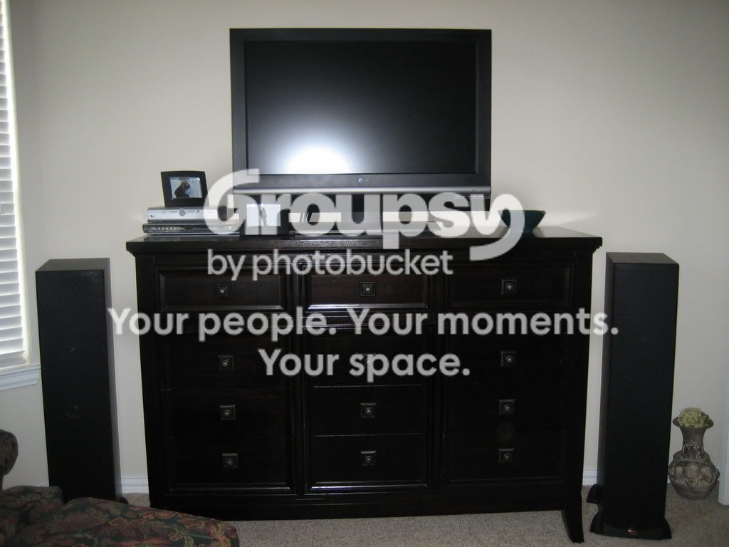

The system that started it all:

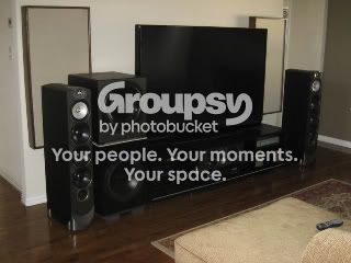

Things got crazy for awhile:

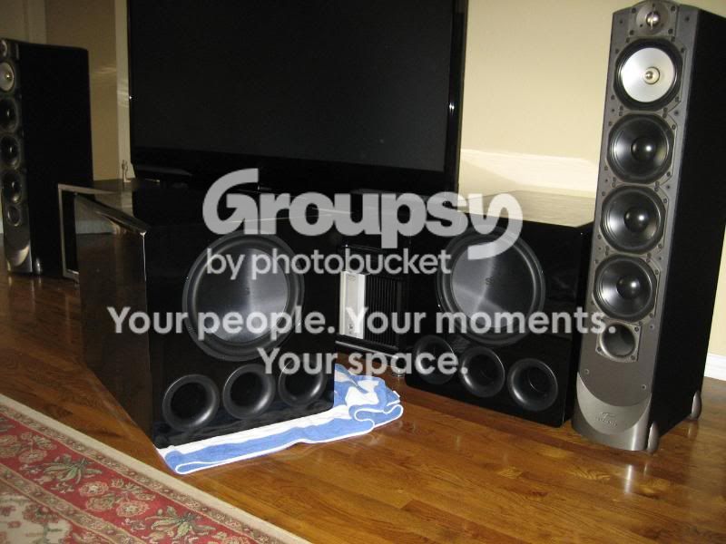

Even spread into the office:

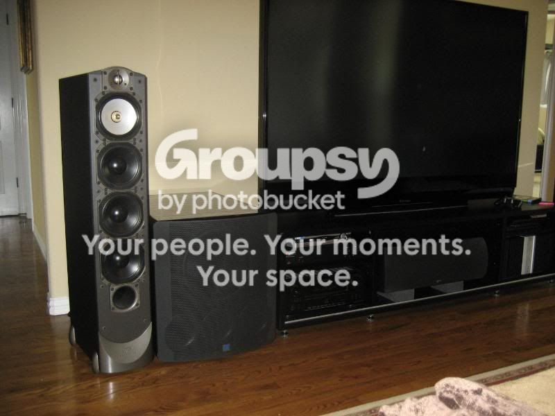

And the bedroom:

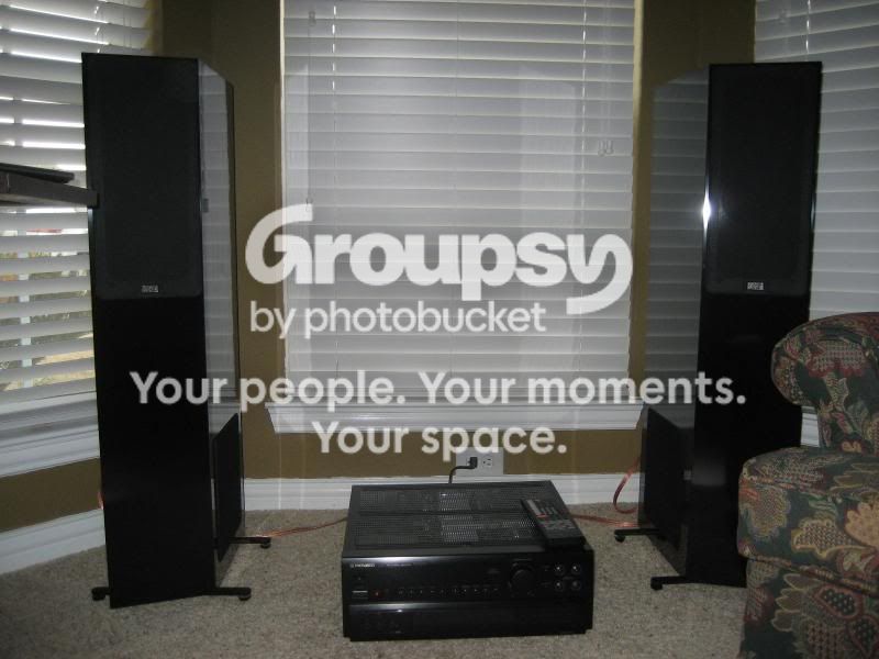

And outside:
