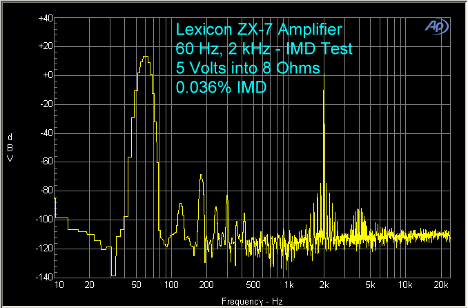

I found these results interesting even though the measurements are not completely comparable:
Lexicon.gifView attachment 11870
These are not into a speaker load but they indicate that artifacts are produced in the audible frequencies.
So the hypothesis is that when music is reproduced additional ringing that may be low level added to the signal may result in audible fatigue or other reviewer and user observations.
- Rich

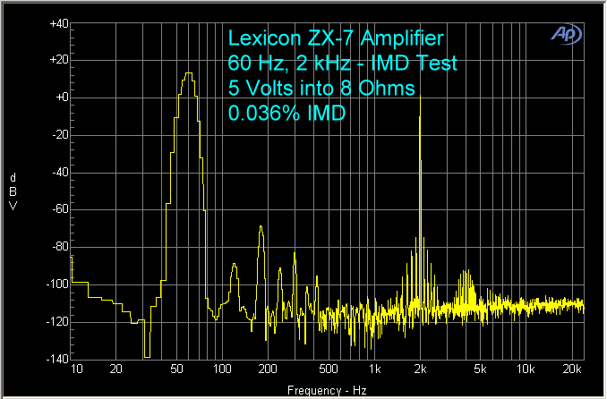

View attachment 11869View attachment 11870
- Rich
To the uneducated guy that I am, does the Lexicon measure better in this example? It seems to me that even though there is greater amplitude, a good chunk of the measurements are between -100 and -120. The Parasound exhibits less amplitude fluctuation, but sits higher on the DB axis.
RichB
RichB
Two non-amp experts talking :)
Yes, it looks that way to me too.
I am not trying the pick the better amp but the question I have is if there are artifacts from any amp at -65 DB at about 200HZ (as in the Lexicon example), what happens if there is music at the frequency at -10?
Do the artifacts then get added to the signal?
If that is the case, then could be much greater amplifier coloring of music than is found in test patterns and this could be one reason that amplifiers can sound different even though they both measure very well.
It would also mean that amps are not nearly as accurate when amplifying music as they are amplifying test tones.
- Rich
I wouldn't qualify myself an expert but if I'm interpreting your statement correctly, the difference you're referring to appears to be in the noise floor of the two amplifiers. Given that the bench tests appear to be done by different reviewers years apart under different conditions, I wouldn't spend a lot of time worrying about it.
Let's suppose for a second they do, and see what happens:
I'll call ref level 100dB because it's a convenient round number. Suppose you are playing a 200Hz tone at -10dB from ref, i.e. 90dB, and you've got a bit of distortion that creeps in that happens to be perfectly in phase at -65dB from ref, i.e. 35dB. What's the sum of 90dB + 35dB? For all practical purposes it doesn't move the scales.
That's of course no fun, so lets ramp up the distortion by a few orders of magnitude to 65dB, ie -35dB from ref and add that to our 90dB signal. Now you get a result: ~90.5dB.
Hope this helps.
internetmin
internetmin
Ah, didn't realize it was different reviewers. So it's not an Apples to Apples test. Thanks for that clarification!

You have to be careful when doing multi-tone distortion tests. The tests referenced from Secrets don't appear to be done with much consistency (test frequencies are different, scales are different, etc). I am thinking about revamping our FFT test to incorporate Multi-tone tests similar to what is done in the Telephone world via IEEE standards. There is a mathematical formula for doing this to get meaningful results. I will try to dedicate some time over the summer on this. 60Hz is the same Frequency of the power line for domestic 120V power, so it should be avoided.
The different tones and scales makes it difficult to compare but I do not think that makes them invalid.
For AH, that sounds like an interesting measurement. Of course, if performed in a standardized manner, results *should not* change from reviewer to reviewer. Some sites like HomeTheaterMag have a measurement staff that *should* be reviewer independent.
