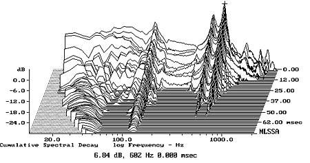

John Atkinson wrote:
"an investigation of the enclosure panels' vibrational behavior with an accelerometer did uncover two fairly strong resonant modes on the sidewall in this region (fig.2)."

CSD plot with accelerometer on the cabinet:
Those don't really trouble me because they are so narrow and so low in frequency. The graph is actually pretty good.

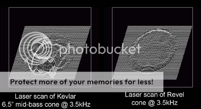

I will: B&W. LOL!
Check it out:
Very nice post... now, what is the cone material showing in the REVEL on the right = ?
and the photo on the left is that 100% kevlar or poly impregnated w/ Kevlar?
N
Nuance AH
Crap...I can't recall what material that particular Revel driver is. I'll see if I can find it again. The B&W driver was woven Kevlar if I remember correctly.
If we are talking about Salon2, then Titanium inverted dome midrange and woofers and Beryllium tweeters.
