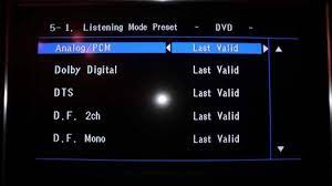

I'm one of the few who actually used this sound mode assign menu? You can't be serious, can you?
I'm SURE there were tons of owners who preferred setting certain modes for certain signal types -- so Pro Logic II was used for 2.0 signals and, for example, Mono Movie was used for mono signals. Sure, direct multichannel platforms like Dolby Digital and DTS would most likely have been left at "Last Valid," which was like an "Auto," but I can't image NO ONE ELSE would have wanted to use the assign feature for other types of signals.

Which unit are you referring to? My Onkyo remembers preferences based on detected codec, as do my Denons but my Onkyo also has the Listening Mode Preset menu (where last valid equates to remembering your preference).

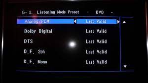

I was referring to OLD Onkyos, like my TX-SR605 -- this is what the Listening Mode Preset menu I keep referencing looked like:
