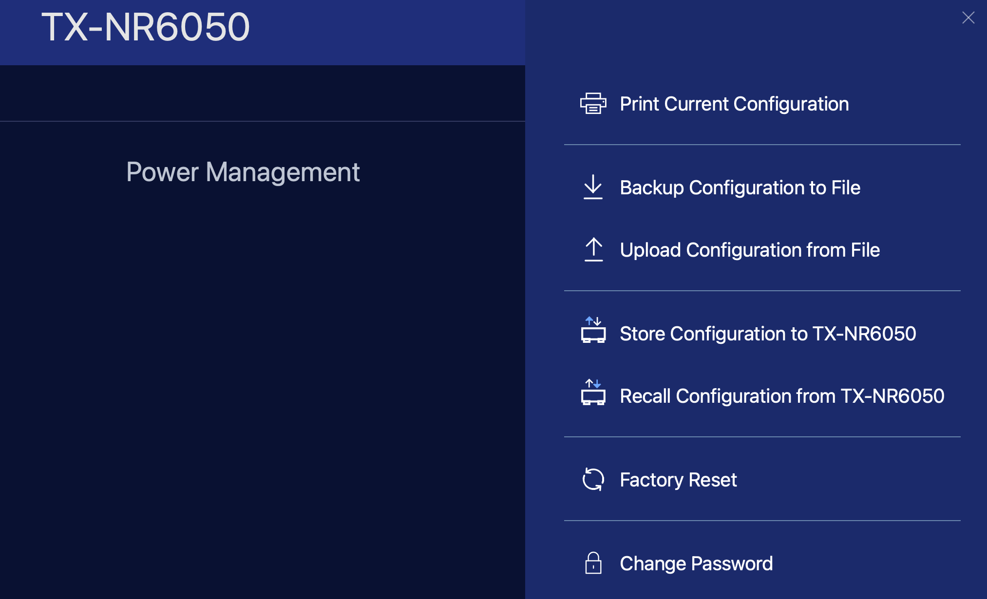

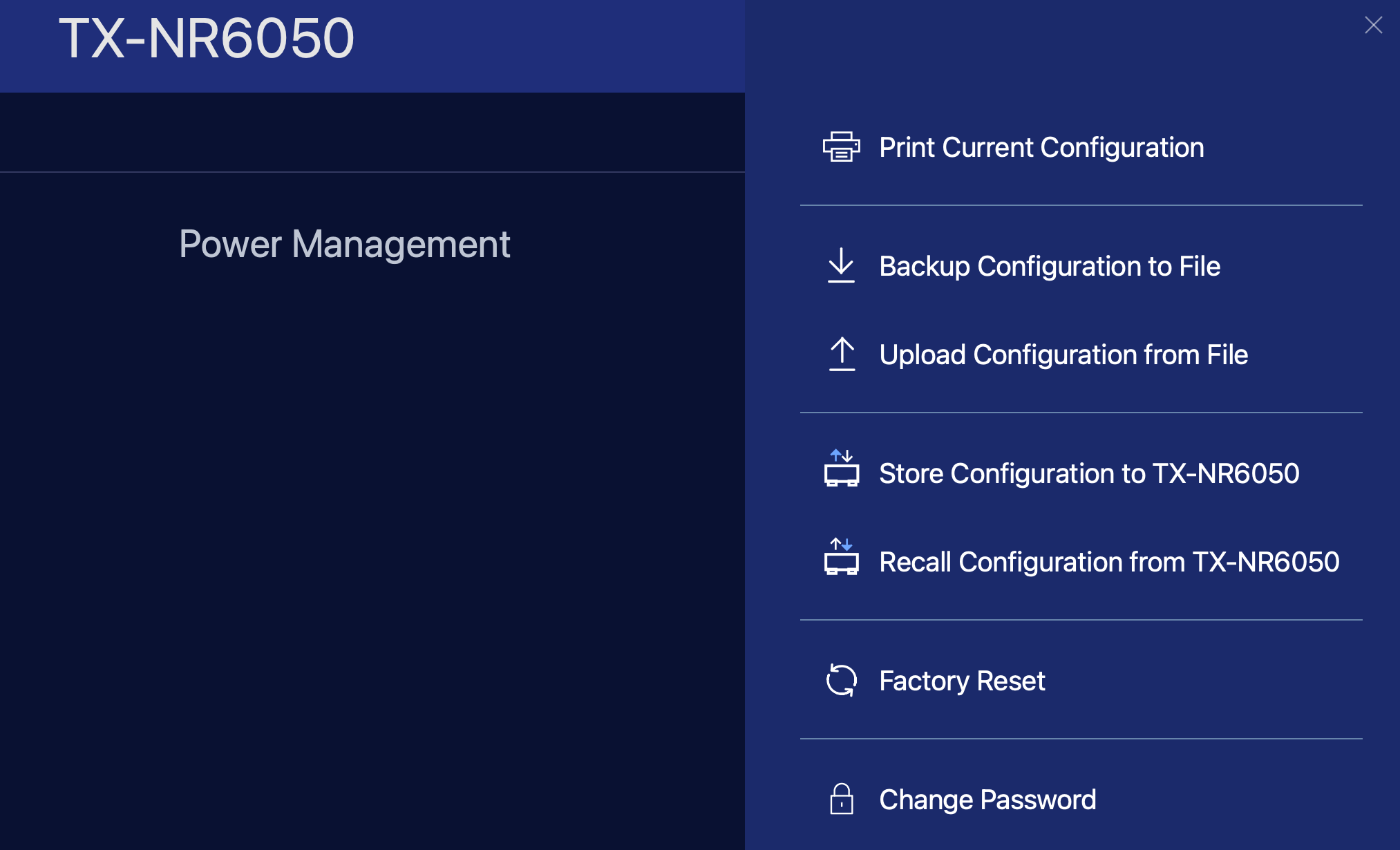

Network connectable Onkyo receivers do have a backup feature that can be accessed from the Web setup. I have my current configuration backed up and have uploaded it after a factory reset.
Trebdp83
There are features available in the Web Setup that are not available in the onscreen settings menu but you’d never know it reading that silly manual.
Yep, and don't forget to tell them you have to log in with the username and pass of "ciuser" or you only see half of what's really there.
That's for all Onkyo/Pioneer/Integra.
