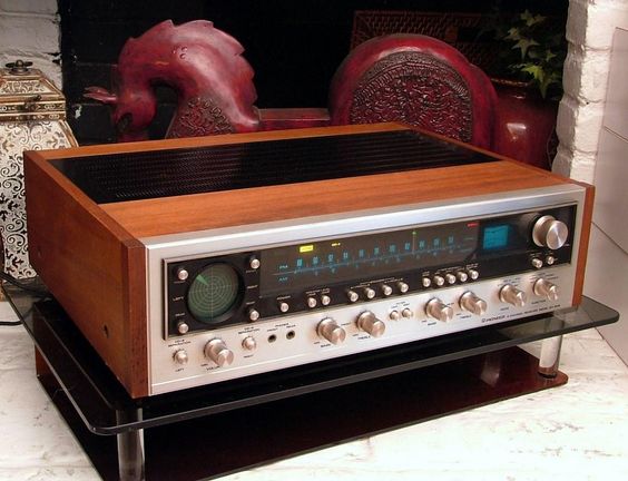

The earliest attempts to market "Quadraphonic Sound" to the public started in the seventies and was slow to catch on. The first to catch on was the Columbia SQ system and its derivatives. This was also slow to catch on, but started to have a vogue in the late 80s and during the 90s. as manufacturers introduced Quadraphonic decoders, with four power amps and an SQ decoder of some type. Below is an example.
For individuals like myself who disliked receivers, there were outboard decoders, that went between the preamp and the four power amps. I had a high end Electrovoice decoder, that could handle SQ and its variants. It is boxed up somewhere in my collection of obsolete equipment.
These systems were not over impressive, and front to back isolation was far from perfect. But I do still have some quadraphonic LPs from that era.

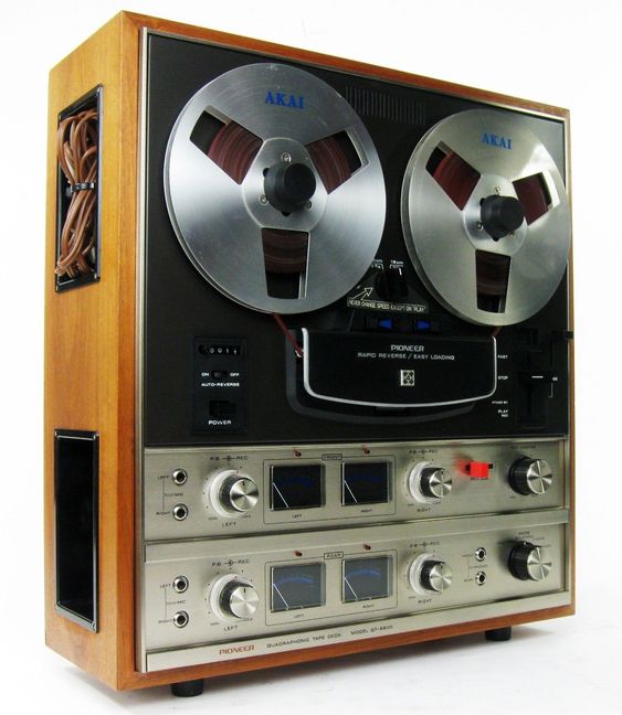

In addition there were four track discreet four channel tapes, and four channel reel to reel recorders to play them back. I never got into that as Studer Revox wisely avoided it. I never owned a Japanese reel to reel machine and have always regarded them significantly inferior to their European counter parts.
