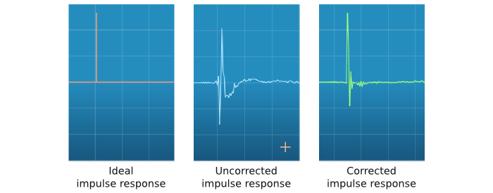

Hi Peng,
this doesn't come unexpectedly as my understanding is that the Audyssey algorithm, in its various incarnations, doesn't correct the impulse response,
In an ideal world there should be nothing before the pulse, after, and especially below:
But does it matter?

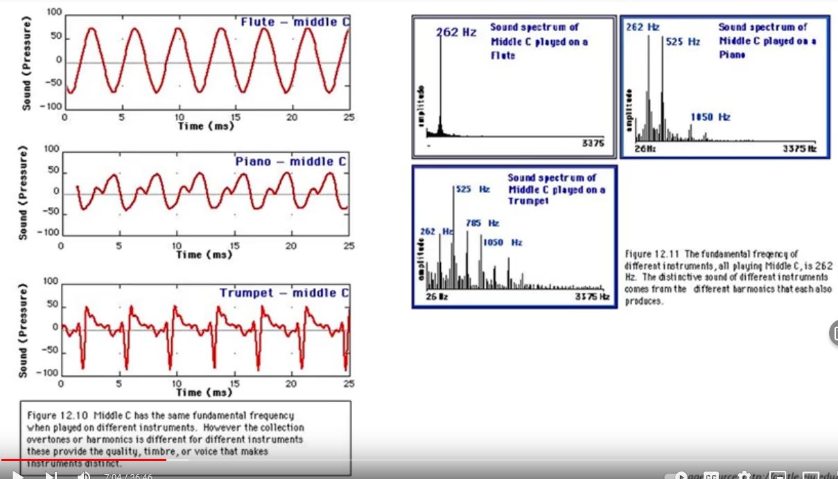

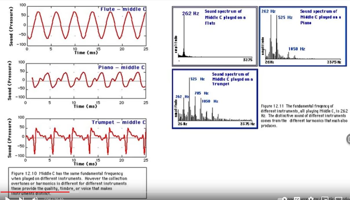

It's more subtle than a change in the tonal balance and it affects the transients, here is a document that (partially) covers the subject:
When reading it, it's worth noting that the harmonics above the fundamental can contain more energy than the fundamental itself (depending on the instrument), and we want the harmonics to arrive at the same time as the fundamental.

Hi Peng,
But does it matter?
