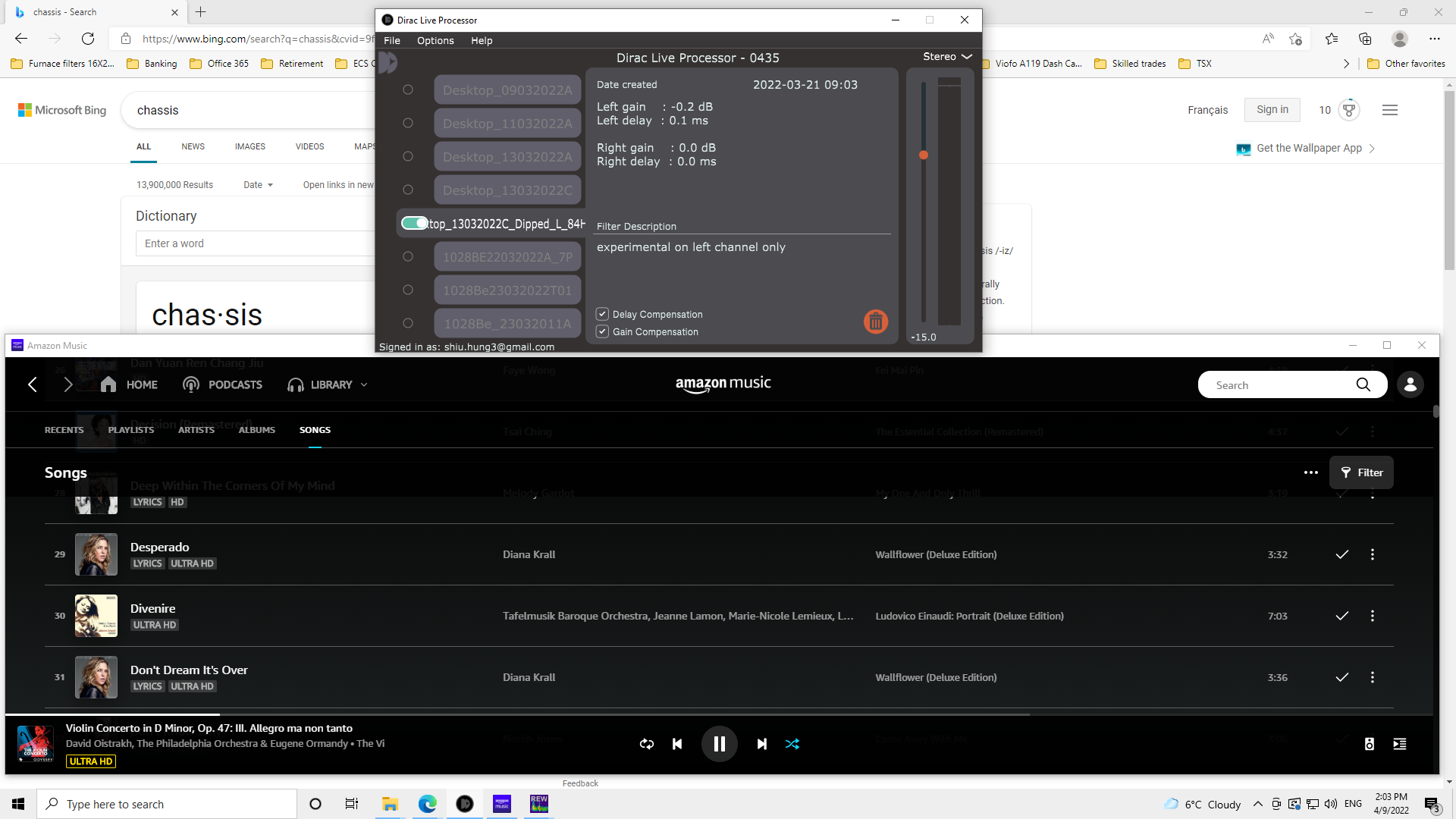

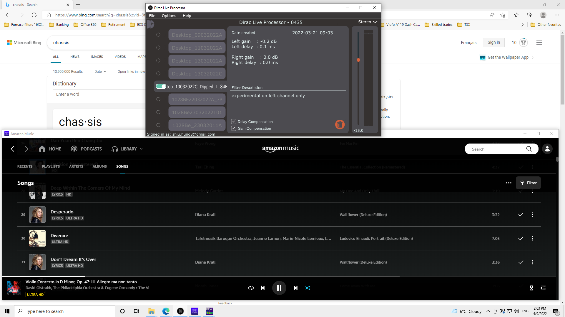

Good thing you ask, I should have talked about the setup and connections. You don't need to use it with an AVR but you can, as long as you use a PC/laptop with the AVR. It runs on the PC, windows or Mac OS (not sure about Linux). Once installed successfully you can run it with the Umik-1 or other compatible mics.
After that, it will just work with the PC whether you play music with Foobar, JRiver or streaming, or whatever you play from the PC/laptop. As I am typing I am streaming from Amazon music unlimited.
It works behind the scene, but you can switch if on/off any time, so it is very easy to compare the On vs Off effect.
I will post more screen shots when I have some spare time.
Edited with a different screenshot to show the oval shape button. Cannot get it on full page though That's the one you can toggle Dirac Live On and Off, the change is practically instantaneous.

So the PC serves as the Processor since it takes the Sound, then EQ the sound first before it outputs the sound to the AVR via HDMI?
Source on HTPC --> Dirac EQ on HTPC --> HDMI to AVR?
PENG
Music File or YouTube on PC --> Dirac EQ on PC --> HDMI to AVR?
Yes, though I haven' actually tried that yet, may be in a few days time I will For now, I guess @flak3 can give a more definitive answer. In terms of usability and sound quality that I have experienced, It is really better than I expected. Did I mention that you can run it on multiple PCs or one one laptop that you can run multiple projects for multiple two channel systems? Very cost effective for people like you and I who have more than one system. You can also get 7.1.2 but it cost $150 more.
If in doubt, It is easy to do a free trial especially when you already have the Umik-1 Mic. Like Jim, I hope you can find the mic though. :D If you are not sure how to go about getting the free trial, I am sure @flak3 would be willing to help.
You know I am one of those who hate to use the term "night and day" difference, not for preamp, dacs and power amps anyway. For Dirac on vs off, especially on my desktop system, I could almost convince myself that under some conditions, such as playback of certain media contents, even Youtube's, there really seem to be night and day kind of improvement.:)
Yes, though I haven' actually tried that yet...
But you are listening to your speakers, so how is the PC connected to your speakers?
I thought the PC is connected to your AVR, which is connected to the speakers?

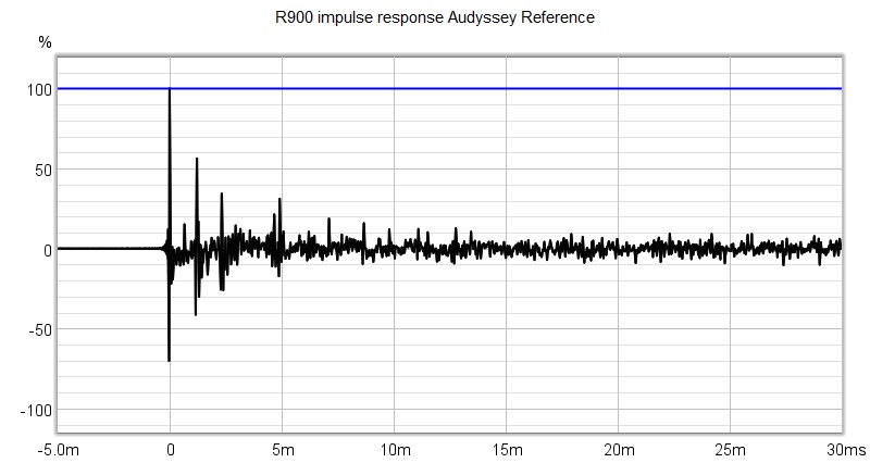

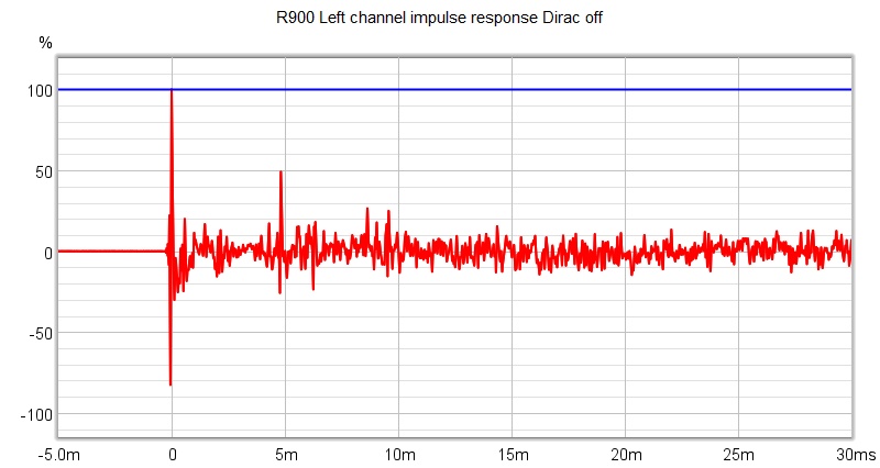

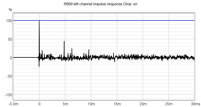

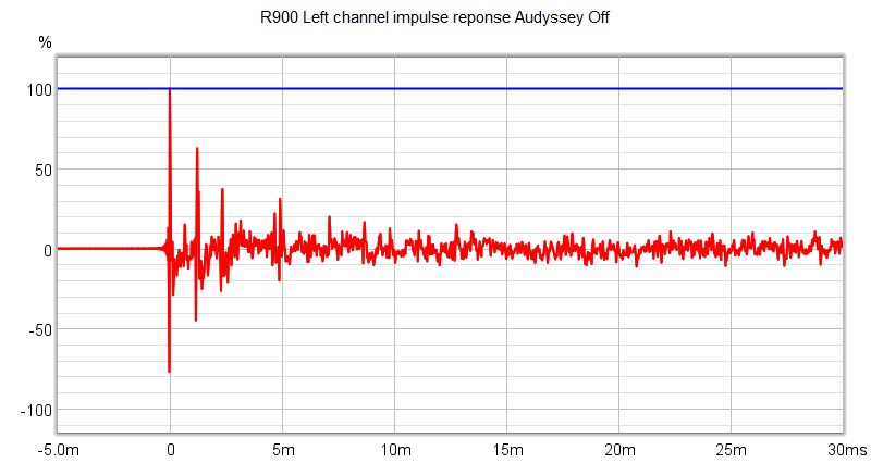

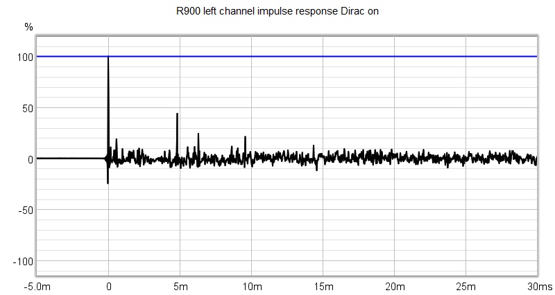

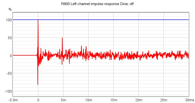

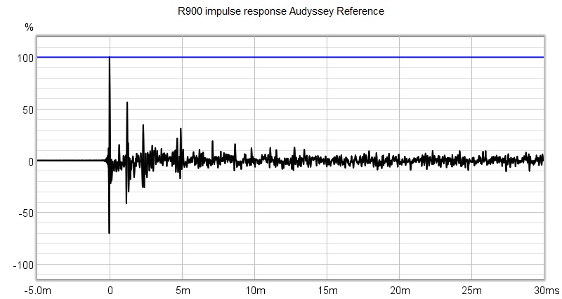

R900 impulse response, Dirac On vs Off:
I don't know enough about how to compare impulse response for 3 - way speakers, but I know enough to say Dirac did do a good job, the results below seem obvious.
The ones for Audyssey were plotted long time ago when I still have the AV8801, the mic positions were quite different, and the speaker placements were also different though not as much. So they are not for a proper comparison but just to get an idea. I am sure there are better ways to look at the impulse response, but I am still at the stage of reading up on the topic.
You are correct, I do plan on connecting from PC to my AVR, once that's done, it will be a matter of selecting the right input and play whatever is played on the PC because the speakers are already connected to the AVR.
I am not using it with an AVR yet so I am having the following connection/signal path using my desktop system for the past several weeks:
PC USB output to DAC USB input.
USB output to my integrated amp analog input.
Then obviously integrated amp output to speakers.
Nice findings... your measurements with comparisons speak for themselves!
In an ideal world there would be nothing below, before, and after the impulse itself:
