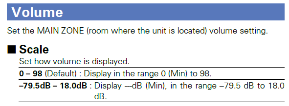

By volume level 70 or 90 I mean when numbers that comes on the screen when i increase or decrese the volume. I don't know whether it's % or db. Volume range from 0 to 100. Isn't it that 100 means 100% volume?

In addition to hd's detailed explanation, below is from the X4000 owner's manual, p.155:
It is 0 - 98 and is not percentage as it is not linear, again, see hd's post#25 for details. If you had run Audyssey properly, 80 (or 0 if you change it to the relative scale) should be about as loud as what you hear in a movie cinema that follows THX standard.
