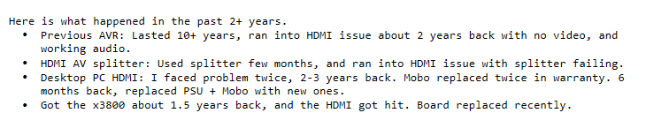

TLS Guy said: 25 ft. is far too long for a passive HDMI cable. You need either a hybrid cable that sends video over fiber, and audio over copper. Or now they have all fiber cables. Your HDMI input on your receiver will not have enough power, to power the cable and it will blow your HDMI board. So you will need a voltage inserter. These cables are directional. This is not voodoo for these cables. If you place it the wrong way round it won't work. Click to expand... Coming back to this thread—after using this setup for quite some time with the fiber optic HDMI cable, I can confirm that I haven't experienced any more issues like the odd flickering screen, or HDMI boards getting fried (Source\Sink). Thank you TLS Guy for pointing me in the right direction! For those interested, here is a nice podcast I ran into at the time I created this thread. Gets into the nitty gritty details of HDMI.
