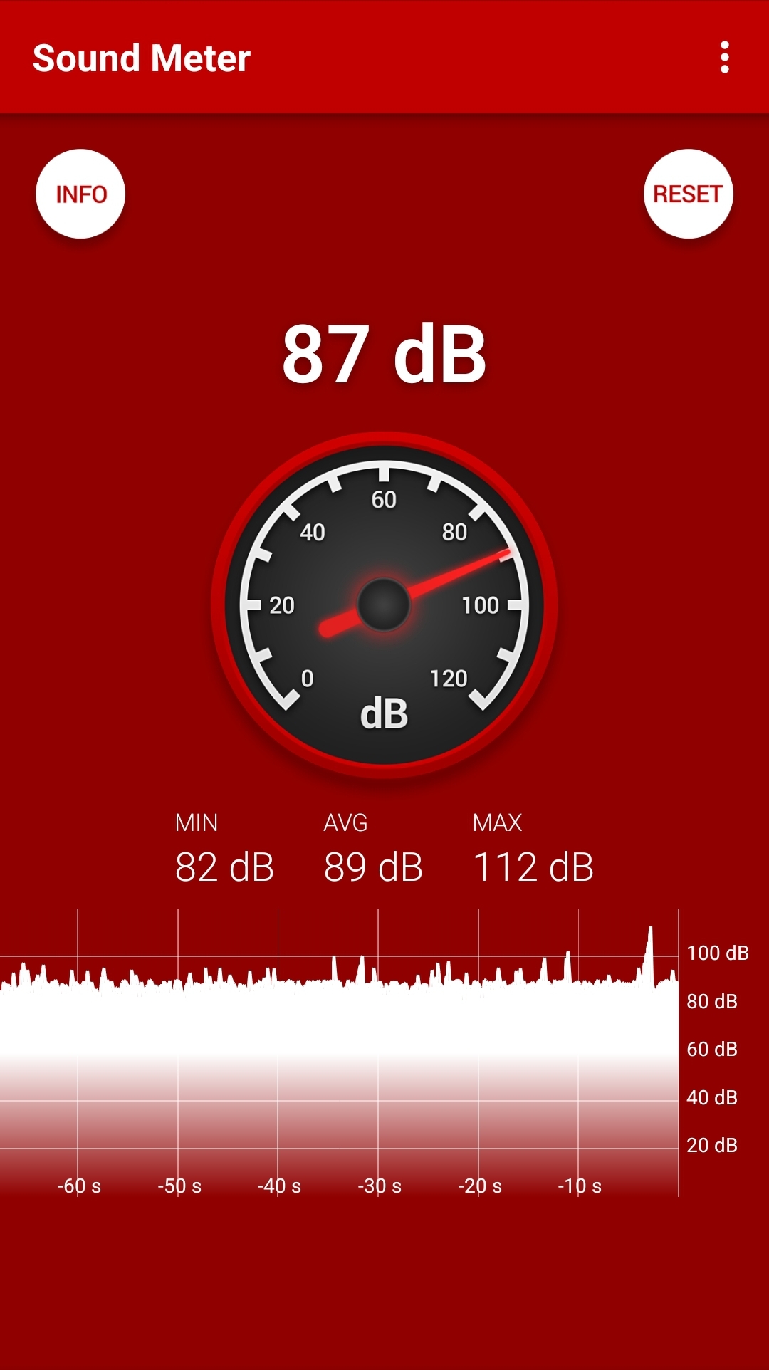

Thanks for the suggestion. Here is the screenshot of the same.
This is at a distance of 3 meters from the speakers with the volume at 10'o clock.
87 dB is not THAT loud. I've measured 105dB (12 FT distance, SHORT TERM since I don't listen that loud) in my old system using the 50WPC $500 AVR and speakers that went down to 2.7 ohms.
So no way your Denon Amp (which Gene measured down to 2-ohms) would shut down even at 100dB - IF this is purely about POWER REQUIREMENT. This has to be something else, not power requirement.
Trebdp83
The issue here is at the 110-115dB range at 3-4 meters with volume at 11-12 o’ clock.
That something else is the phase angle and a large apparent power requirement.

At what peak dB does it go into protection?
The above measurement is with volume cranked up to 10'o clock. It goes into protection only when cranked up to more than 11'o clock..
I avoid doing so too frequently to prevent the amp from blowing out. At 10-11 'o clock, it plays flawlessly for as long as I wish..
I would caution you that if you buy a more powerful amp, you might blow the bass drivers instead of the amp. Those drivers are taking a lot of current from what I can tell from the NRC measurements. That is going to generate of a lot of heat in the VCs. I would strongly recommend those speakers be used with a sub or better two subs, if you are keen on spl. levels that high.

Still curious what the spl was at the time (and will vary with content)....but if peaks louder than 112 not surprising you run out of juice. Might play around with this http://www.hometheaterengineering.com/splcalculator.html
