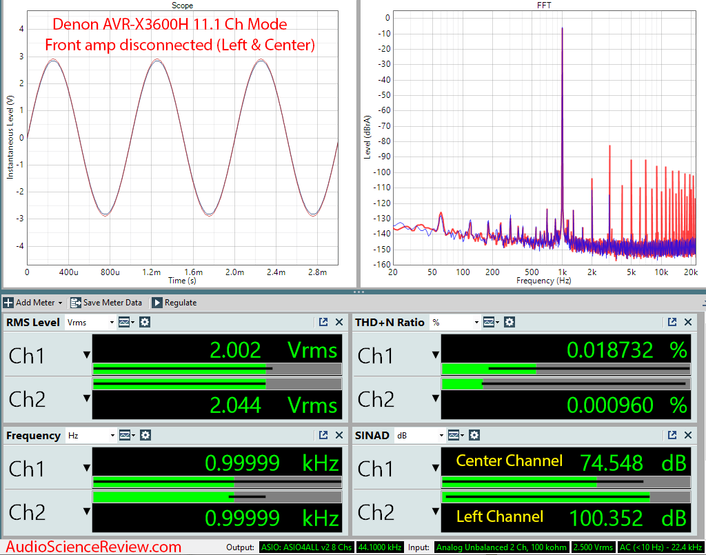

For movies, the center channel is typically more demanding than the left and right, but the Denon can output much higher than 2 V, just that distortion pass at higher than about 1.5 V will increase, by the time it reaches 2 V, when the Monolith will be at its rated output, THD+N from the center channel pre out will at about 0.0187%, but that is just about the same as the Marantz AV7705. That's pretty amazing isn't it. And I highly doubt you have to worry about the AV7705's distortions for movies.

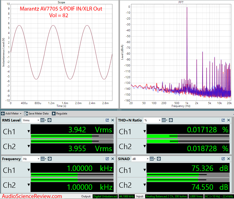

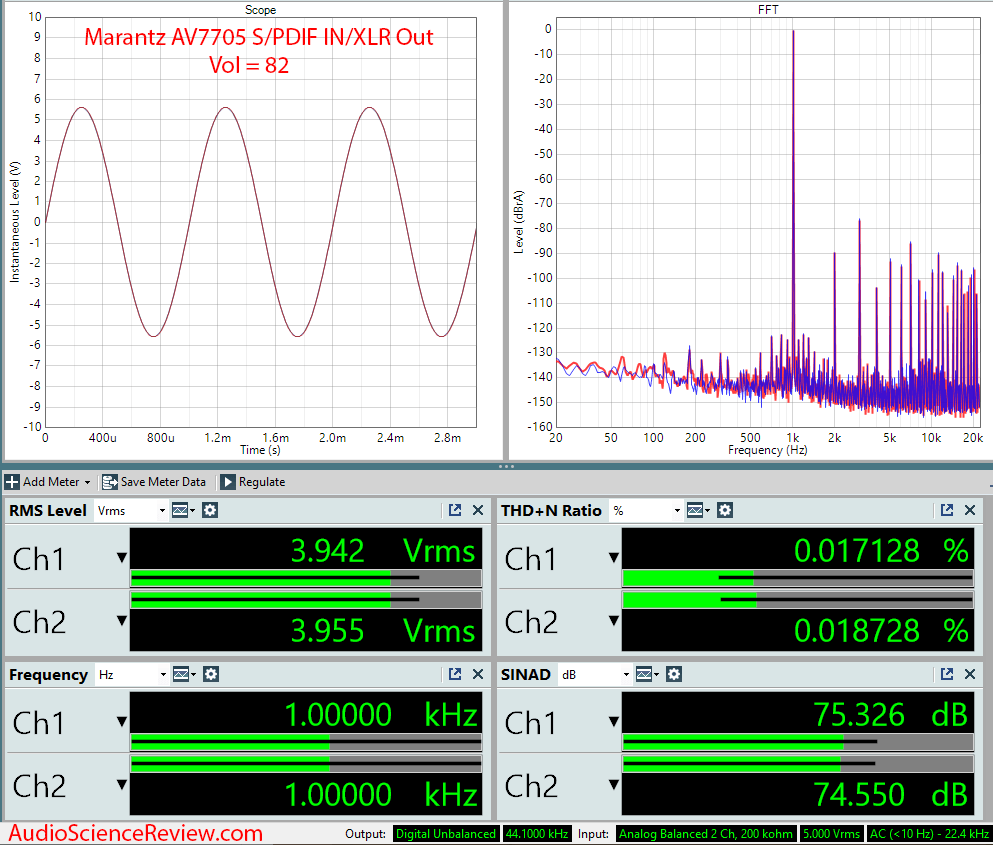

Below is the comparison between the AV7705 (a prepro) and the AVR-X3600H's (an AVR) center channel that cannot be disconnected so there affected by the power amp at the 2 V output level.
For an apple to apple comparison, the Marantz AV7705's 3.955 V is actually 1.9775 V if unbalance RCAs were used, so the comparisons below are fair, i.e. truly apple to apple.
