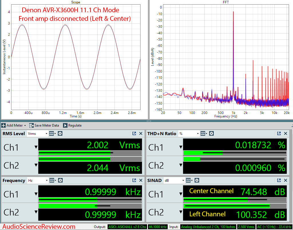

In terms of power needed to "control the cone movement.....", It is true that you need to have enough current output from the driving amplifier for the particular speakers it is driving, but if you listen to well below reference level and the amp is only outputting a few watts with peaks to may be 30-50 W, then most 4 ohm nominal well designed speakers such as KEF, Revel, Focal, SVS, Elac's etc., will have all the currents they need for them to behave well.
Let's see a numerical example in the comparison of amp A and amp B below (all values are in RMS)
Amp A is rated 300 W into 4 ohms, so rated current is 8.66 A (formula not show, so trust me..)
Amp B is an AVR, rated 100 W into 8 ohms, 50 W into 4 ohms, so rated current is 3.54 A
Obviously Amp A can deliver more than double the current that Amp B can, but it should be obvious to anyone that if the speaker in use only needs say 1.5 A to produce the maximum peak SPL the user needs at his mlp, then it would make no difference to the speakers which am is in use. Simple and logical right? If not, please tell me why.., if yes, then stopped listening to hearsay created by professional reviewers who have little technical knowledge. Again the principle is correct but if stated as a general blanket statement then it can be misleading to a lot of people
Now back to your question about the 4700 vs 6700, assuming you are referring to the 2020 Denon AVR-X4700H and X6700H. If you are going to use external amp and you don't mind not having the DTS:X Pro, then in my opinion the X4700H is the better deal.
It is just too bad you have to use the amp assign trick because the new preamp mode is all or none. I hope you voted yes in my thread on a FW upgrade to make the preamp mode flexible.
For movies, the center channel is typically more demanding than the left and right, but the Denon can output much higher than 2 V, just that distortion pass at higher than about 1.5 V will increase, by the time it reaches 2 V, when the Monolith will be at its rated output, THD+N from the center channel pre out will at about 0.0187%, but that is just about the same as the Marantz AV7705. That's pretty amazing isn't it. And I highly doubt you have to worry about the AV7705's distortions for movies.
Below is the comparison between the AV7705 (a prepro) and the AVR-X3600H's (an AVR) center channel that cannot be disconnected so there affected by the power amp at the 2 V output level.
For an apple to apple comparison, the Marantz AV7705's 3.955 V is actually 1.9775 V if unbalance RCAs were used, so the comparisons below are fair, i.e. truly apple to apple.
Very insightful, but it almost makes an argument for the 2020 Denons run in pre-amp mode doesn't it? I mean, if you could get 3 or 5 or 9 channels measuring at Ch2 example above, that would be a better result than either option illustrated here, right? Please know my intent is to learn, not to be argumentative! I don't really know what is audible and what isn't. Look at ASR results of (my) AVR850. I mean should I bin the thing and go this route? I plan to for 2CH changes on the fly, onboard streaming, discrete sub outputs, Auro 3D..... but ultimately it's about achieving the best sound possible within my budget. And no I didn't pay $6,000, or even $5,000 for the 850. I have some money to spend, I just want to spend it wisely. From previous experience the Denon stuff almost always just works, is somewhat straightforward to set you and sounds good. I looked at the T778 too but it appears as quirky as the 758 V3 was and while I can figure stuff out, I'm getting old enough I want to listen and enjoy instead of power cycling my equipment to get it to work or having to read forums for two hours to set up my inputs......
