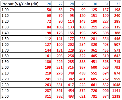

So basically, if you intend to pair your prepro, or AVR with a power amp, 2 Vrms output would be fine for amps rated 200 to 300 W max, and have voltage gain of 28 dB or higher.
I measured my AVR-X4400H and AV8801 and have no doubt they both can output 4.0 Vrms without any obvious issues, but I am not sure if the THD+N at that level would still be acceptable, as i don't even have a spectrum analyzer, let alone the highly regarded AP analyzer that Gene has.
Below is from my Excel spreadsheet that shows the achievable power output vs voltage gain in dB and preout voltage in Vrms.
Blue - Gain in dB
Red - Achievable power output in Watts

That’s a great chart, PENG!
So if you own the A860 pre-production model (1Vrms) and you own an amp with 32dB Gain, you could output 200W, not that you want to do that. :D But if you have a 26dB amp, the 1Vrms gets you 50W. :D
Do you know what the preamp output voltage of the Yamaha A1080 (any 1000 series or higher) is?
