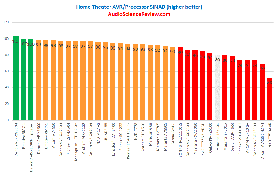

Based on a couple of indicators, the main one being the SR7015 that has been measured at ASR, I would bet at least 3 to 1 that the AV7706 would measure about the same as the SR7015 but let's hope for the best.:(
I would be very disappointed if I bet right, because they appear to have increase the price significantly over the 7705. So I expect them to have the better performing HDAMs that the SR8015 apparently has been treated with. Again, we have to wait and see the measurements before we know for sure. For now, all we know is, the 2020 SR7015 is a disappointment, for those who care about measurements regardless of audibility.
It's odd how the Denon 3600, 3700, 4700 and 6700 measure significantly better than the Marantz models over at ASR. They are all from the same conglomerate so I imagine they share resources? @PENG - Do you think you would actually hear a difference in a listening test between the Denon vs Marantz models found on the chart below?
No I don't think I could hear a difference in direct/pure direct mode using analog inputs. I think some people may be able to hear a slight difference using digital inputs regardless of modes, but only if they listen hard and only with certain media contents that has a lot of energy in the above 10,000 Hz range.
The only thing that I could find, after comparing some schematics, that could explain the difference in bench test measurements are a) Marantz has the ill conceived (obvious they won't agree if asked..) HDAM placed between the pre out and power amp input, and b) they used a slow roll off DAC reconstruction filter that resulted in a slight roll off started at about 10 kHz, but down by only about 2.5 dB at 20,000 Hz, whereas Denon uses the typical fast roll off filter that most others use, resulting in a virtually flat FR to >20,000 Hz when digital inputs are used. Other than that, the two are practically identical in terms of parts and circuitry.
Regardless, the differences are mostly academic for most users, but that's just my opinion based on my extensive research on the audibility of distortions/noise as well as their (D vs M) known difference shown in publicly available info, including those in service manual, and also my own experience with two Marantz AVP and several Denon AVRs.
