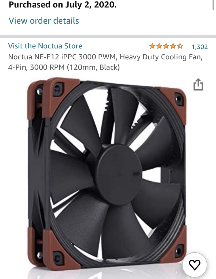

I was worried those fans wouldn’t be enough, and I was willing to invest the 120 on those 4 Noctua fans but it works out just fine.
Many people say like the AC infinity has a temperature read out on the unit. Which is fine, but if you touch the top of your unit and it feels like it hasn’t even been turned on there’s absolutely no point in needing that.
They aren’t loud either, you can adjust the fan speed with the controller and I always put it on max speed and a lot of the time I forget to shut it off and can’t even notice it.

These are the specific units I’m talking about.
They are the monsters, one of those fans has 3 and 1/2 times the power of one of the cooler guys lol
But do you need such a large capacity fan? What's the dB level at its minimum 750 rpm? The max level looks pretty high....
