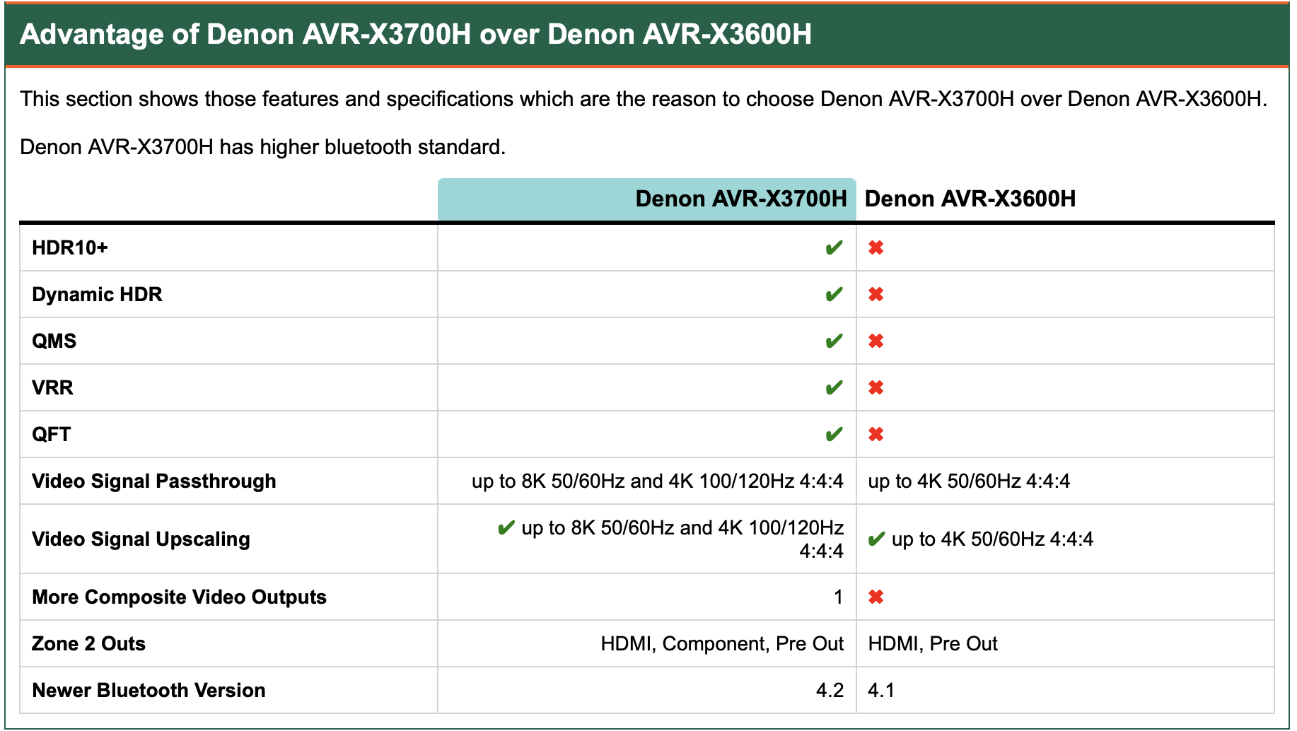

Here are the main differences between 3600 and 3700.

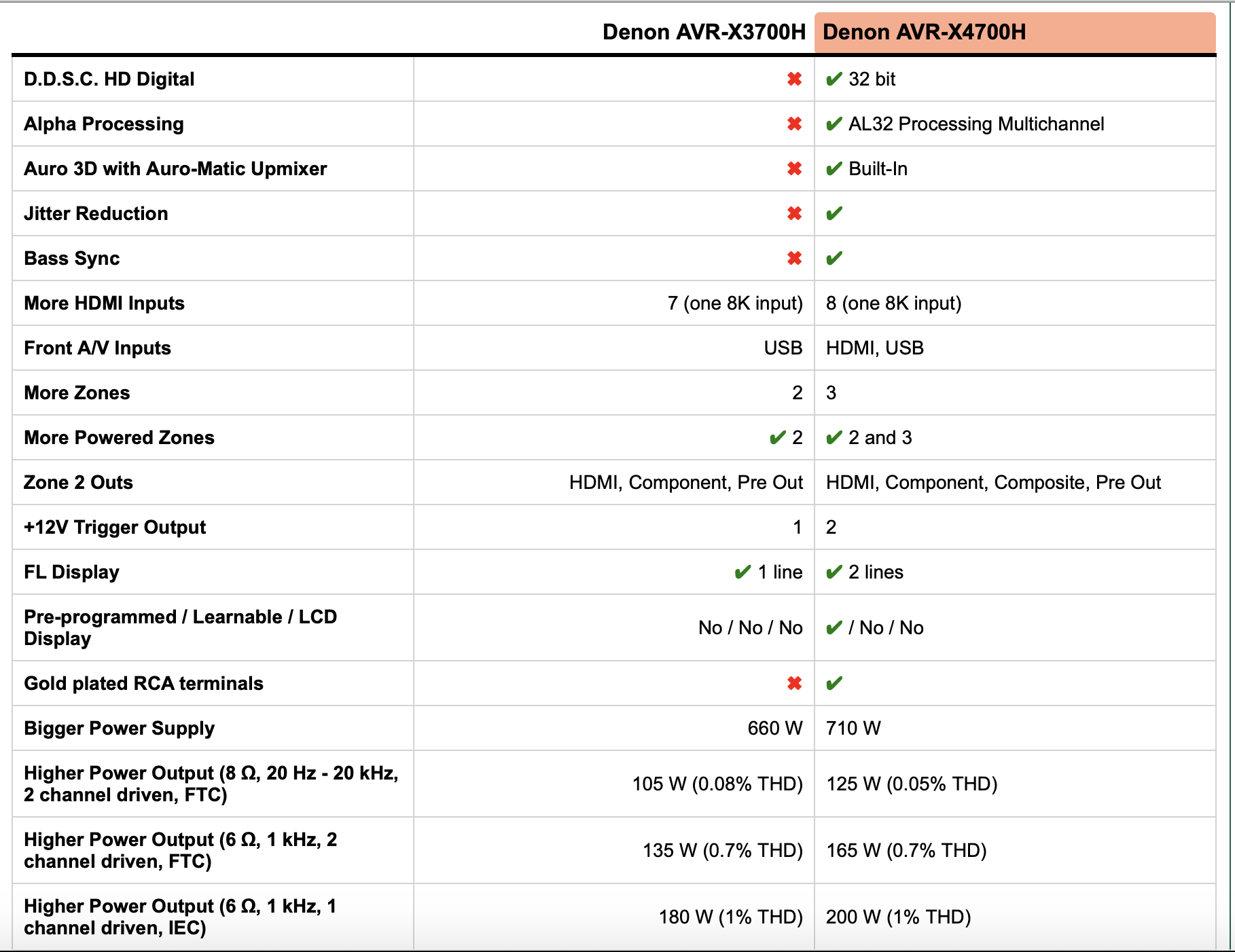

The 4xxx series adds more features. Here is a 3700 vs 4700 comparison.
One of my favorite modes is Auro-3D. It's not available on the 3700. I also like 2 lines on the display instead of one. A little higher power and lower distortion is also part of the package. The 3700 and 4700 add preamp mode where users can turn off the internal receiver amps. The 3600 and 4500 do not. But they do allow you to use an external amp for the fronts.
The 4500 is an older design that's been around for several years. A this point, if I was looking at the 4xxx series it would be worth the extra to me to get the 4700 vs 4500.
The other option is Yamaha. The RX-A3080 and RX-A2080 reportedly run cooler than the 4700 and offer more power in Stereo mode.

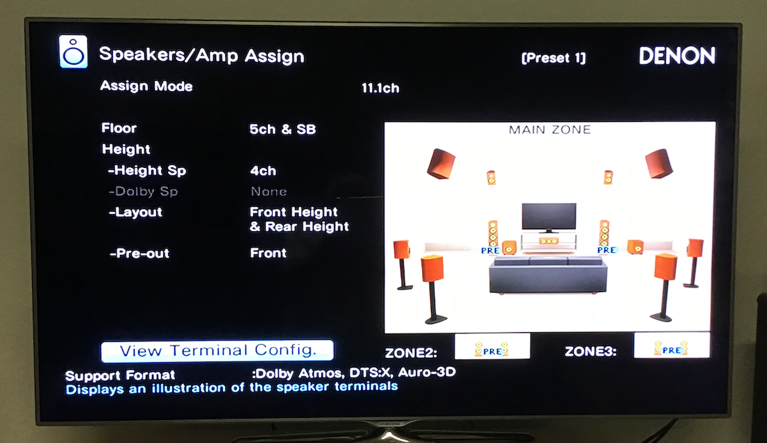

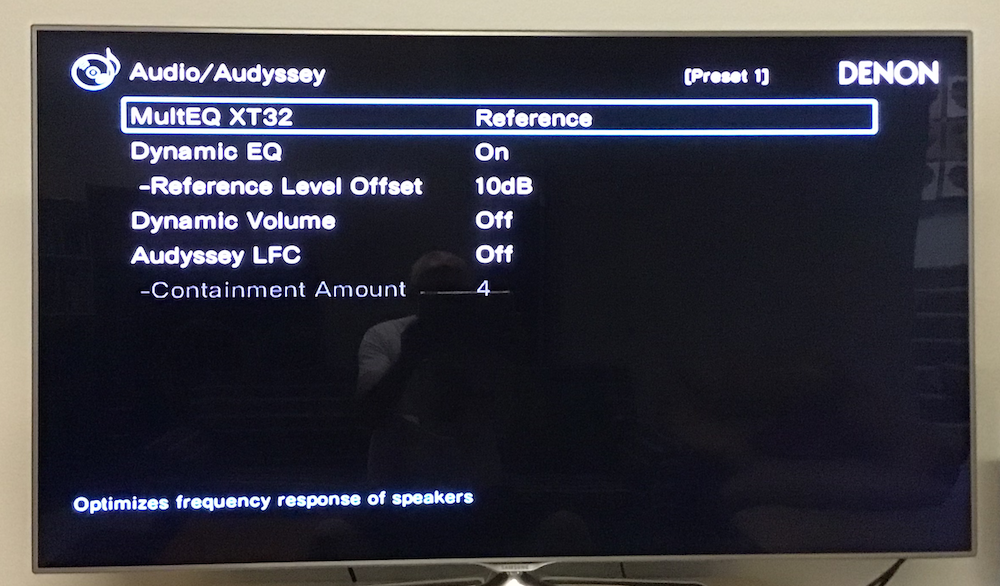

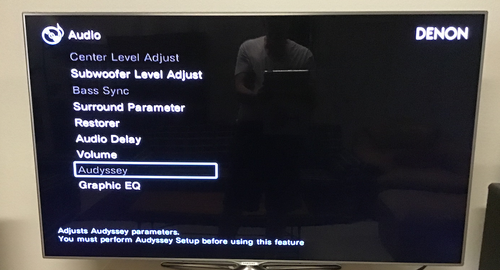

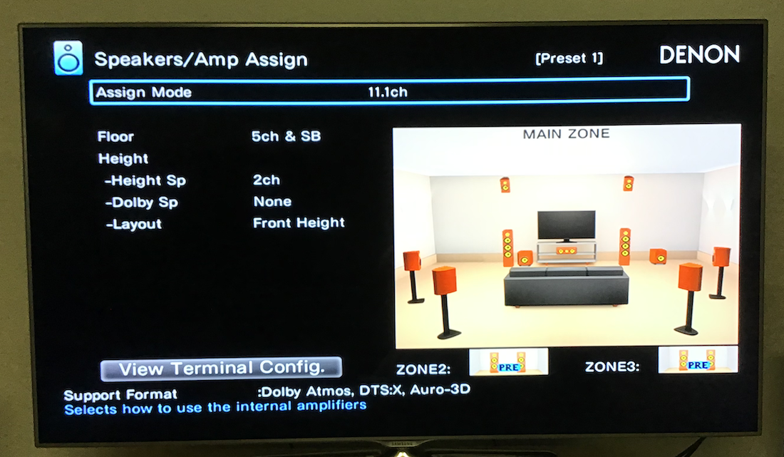

@PENG - I wish it was easy as simply changing Amp Assign and moving on your merry way. But with the 4700 that is not the case. Maybe it's different with your receiver?
Here's why:
My normal setup is shown below. Fronts, surrounds, rear surrounds and front highs. There is no option in Audyssey to use front pre-outs in this configuration.
So I take your advice and I open "Amp assign" and switch Height speakers to front and rear. This enables the option for Front pre-outs. It's odd that I have to add 10 speakers just to get this option but I do it to work around the Denon 4700 design.
Then guess what happens? Audyssey is now greyed out on the monitor and not available. All the EQ is gone and Dynamic EQ is turned off. Audyssey says I can't access this menu until I run Audyssey again.
As you can see, you cannot maintain your settings when you move to a different "Amp Assign" setting. As a test, I go back to "Amp assign" and select Pre-amp mode. Once again all EQ settings are lost and Audyssey menu items is greyed out and Dynamic EQ is off.
Next, I move the Amp assign back to my original configuration. Only then is the Audyssey menu item available and Dynamic EQ restored. There is NO provision in the 4700 to change amp assign modes without completely re-running the entire 15-20 minute Audyssey setup confirmation with the Mic inserted.
And if you want preamp mode, you will need to run an Audyssey setup for that and save it so you can switch to it. The 4700 software is not designed to make it easy to change amp assign modes without a complete redo of Audyssey.
Maybe you have not done this? Or your older Denon is different? You really have to stay with the amp assign mode you originally configured or be willing to start the setup all over again.
Here's why:

@PENG - I spent half the day trying different modes with the 4700. Setting up a 7.1.4 setup does NOT fix the issue. It does allow you to use preouts with fronts but if you move to preamp "amp assign" then you have to rerun Audyssey all over again or Audyssey EQ does not work, Dynamic EQ is off and the Audyssey menu is greyed out.
Basically, it's a hot mess. If you want to change amp assign settings "on the fly" it's not possible with the 4700 without getting the mic out and setting up Audyssey from scratch again. :p
