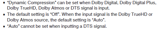

I also read about some reported that it being turned on by itself with Dolby signal. I have no idea what happened to those people. If you go to the menu, press set defaults, it would set loudness management to "ON" and Dynamic compression to "OFF". I have never seen it changed to "Auto", after playing many Dolby stuff, disc, or digital files...
Now, the owner'a manual is confusing as it says:
See the confusing part in the second bullet. That's why I ran some test with Dolby disc/files, again, have never seen it changed to "Auto" from "Off" automatically. Would you please try it too and see what happens, if you have some spare time?
I was running some discs last night and was checking on this same thing never once did it get set to auto. I think with mine the first time was due to previous owner setting it there and I was not aware to look out for it.
I think you are right. If one wants to make it bullet proof, one can set loudness management to off. That way the DRC adjustment is disabled altogether.

That's what I did I just turned the whole thing off
