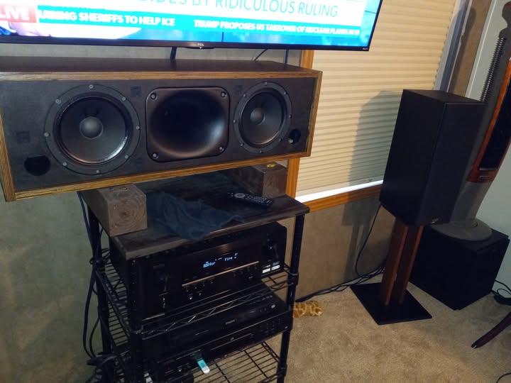

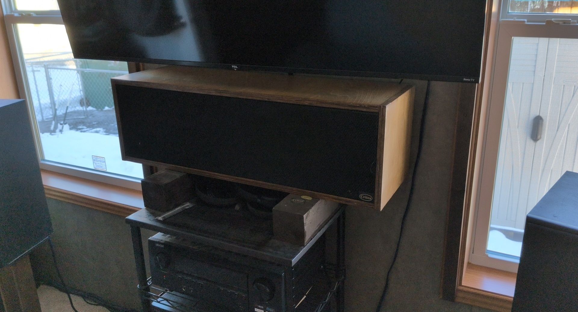

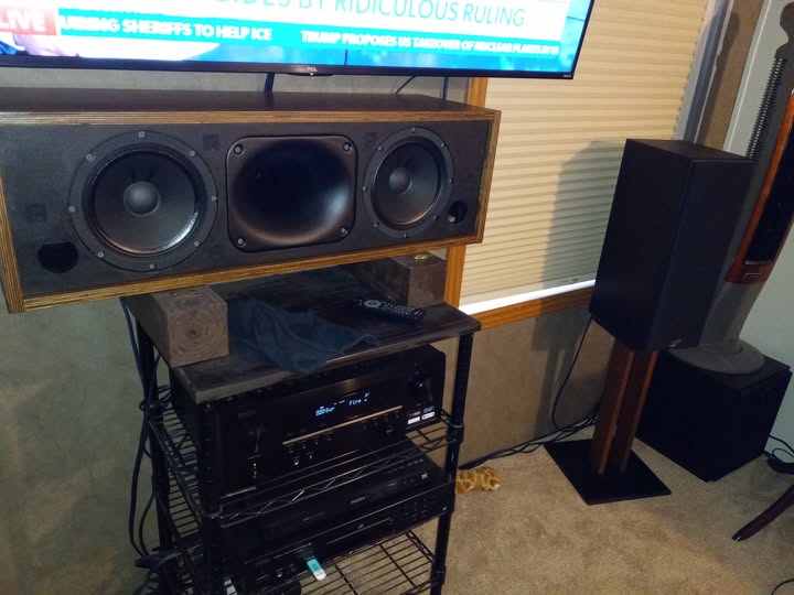

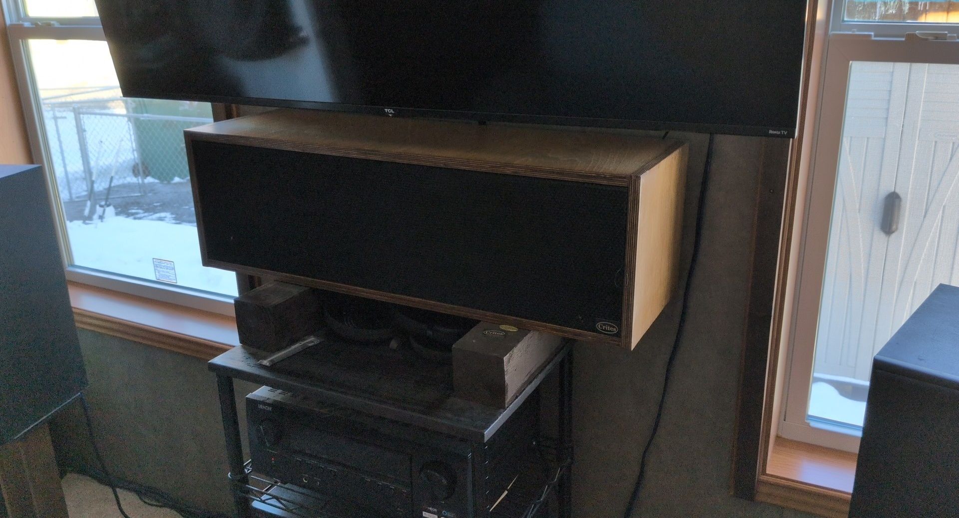

It's a Crites CSC-1. Here's a couple shots of it. I really like it a lot. Sounds extremely clear. It may not be congruent with my mains, but the system sounds fantastic to me. The subs are front-firing 300 watt units. I do have a down-firing 10" Klipsch in another room.

It's a Crites CSC-1. Here's a couple shots of it. I really like it a lot. Sounds extremely clear. It may not be congruent with my mains, but the system sounds fantastic to me. The subs are front-firing 300 watt units. I do have a down-firing 10" Klipsch in another room.View attachment 77124
What fronts are those ?! They look big.

Details of my systems are in the signature here. The mains are not big. Ascend mini towers. I got them free from a guy at work. When he moved, someone damaged one woofer in each speaker. So I purchased 2 woofers from Ascend. They are just perfect for the situation. Plus, I got the the stands for free when I bought some large ADS speakers that I ended up selling soon after I bought them. But I kept the stands.
