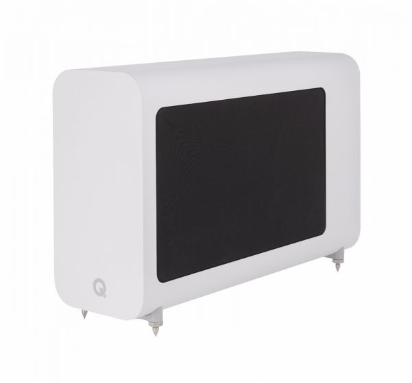

Q Aquistics 3060S subwoofer, it came together with the 2 tower speaker and 2 bookshelf speakers 3020
Pogre
Pogre
Is it this one?
If so, you my friend, have enormous potential for real, audible sonic improvements to your overall sound by replacing that sub. How big an area are you working with? I haven't looked up those speakers yet, but there appears to be a disproportion between the quality of your speaker system and the quality of your receiver. How far along are you? Too late to consider possibly changing direction with speaker choice?
Okay, okay.. too fast, lol. Subwoofer. You have huge opportunities there.

Is it this one?
Yes, this is the one exactly.
Is it not a good sub? What about my speakers, are they also not good?
Please let me know, coz I thought I have bought one of the best in the market
The speakers I have is Q Aquistics 2 tower 3050 and 2 bookshelf 3020, in addition to that sub
