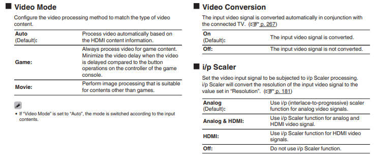

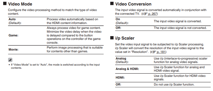

Just out of curiosity do you have the up scaler enabled on the Denon? It is on by default I think. Normally I have turned that stuff off and just run direct passthru. For the Yamaha I also had to set the Mode 1 for 4K, the default was Mode 2, which limits the 4k output to 50/60Hz 4.2.0.
Some of the settings are on P180 of the 6012 manual.
I shall look into that. I think one of the modes on it is switched ON.
