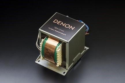

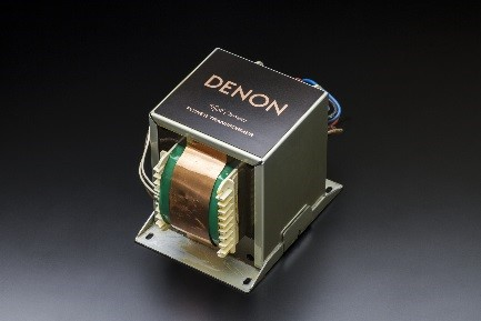

I can see the layout and what parts are heaviest like that transformer!
The amps what are the class-D type? I don't have any too many yet, nitpicks with class-D wow lots of power by and the people.
I can tell all the video and audio boards etc are located at the back with ribbon cables leading towards the front for the soft-keys and front display video switch and volume control.
You are right, that little thing weights 8.2 kg = 18.1 lbs that's heavier than a whole Yamaha RX-V365. 5.1 AVR soaked and wet.
The amps are class AB type.
